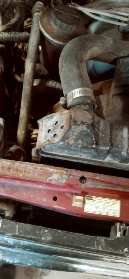

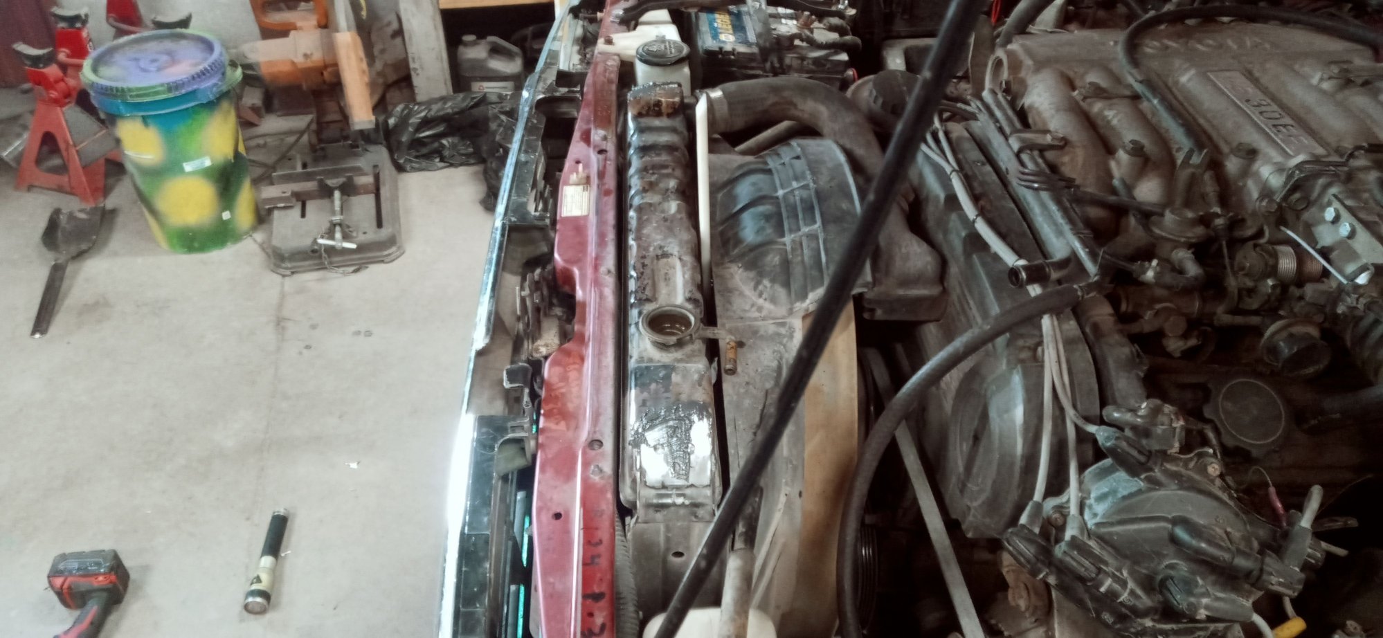

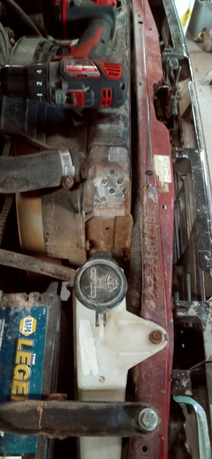

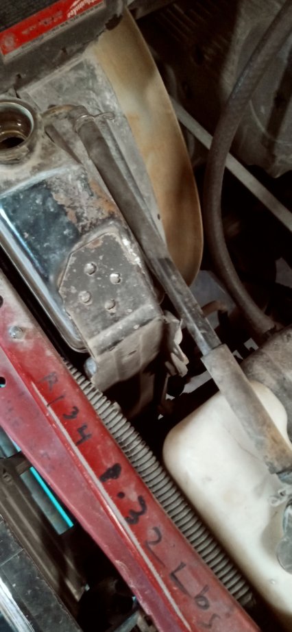

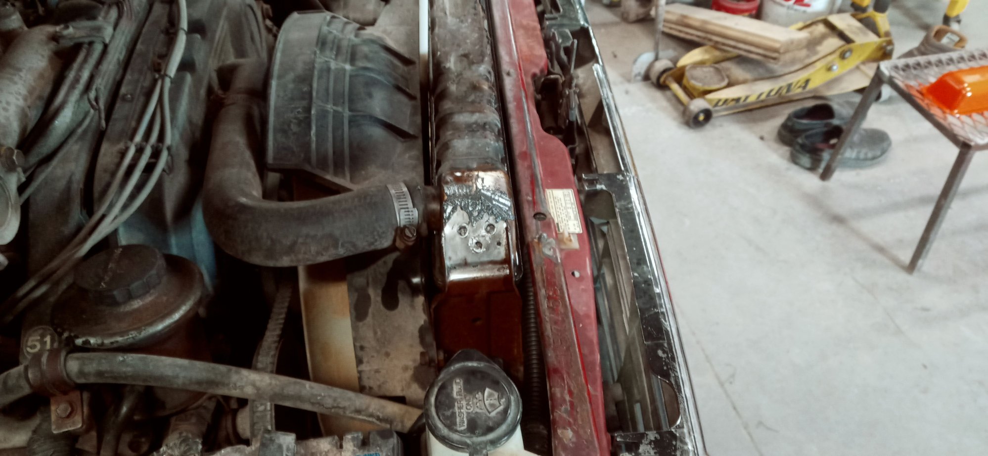

Well after reading what some of you guys had to say and thinking on it for a bit I decided today I was just going to check out my rad more and really it's not that bad, it's fairly clean and I never had any overheating problems even going up 8% grades it's just came unsoldered on the mounting brackets so I thought I was going to fix it today and tried to solder it but I don't have any gas for the torch so I used my propane canister one and it is pretty much out so I couldn't get the solder hot enough. So I ended up just putting jb weld on it for now
