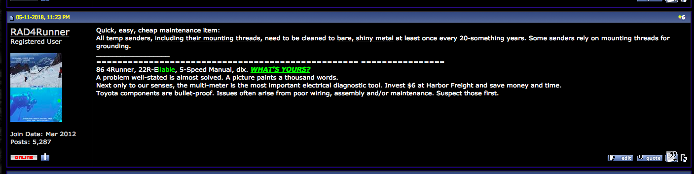

Old May 11, 2018 | 10:23 PM
RAD4Runner's Avatar
Joined: Mar 2012
Posts: 7,125
Likes: 681
Quick, easy, cheap maintenance item:
All temp senders, including their mounting threads, need to be cleaned to bare, shiny metal at least once every 20-something years. Some senders rely on mounting threads for grounding.
