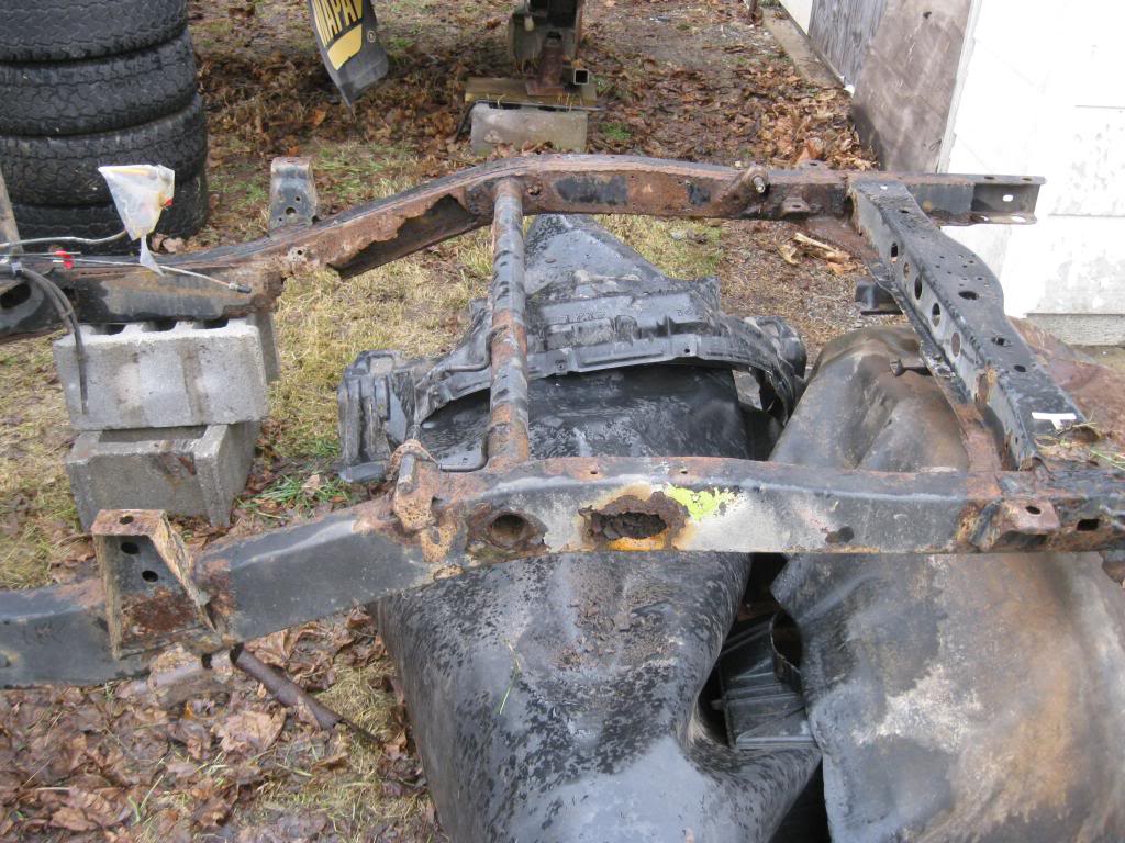

I lifted off the 7'x10' dance floor and found a 'wet' brake line with a pin-hole leak where the gas tank seam collected crud next to the frame. Caveat emptor. It dissolved the frame.

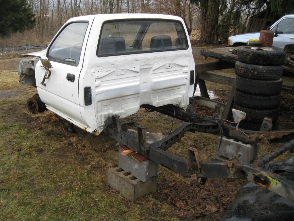

Cab removal. Two of the most difficult tasks turned out to be, no surprise, seized cab mounts, especially the one under the driver's pedals, and...

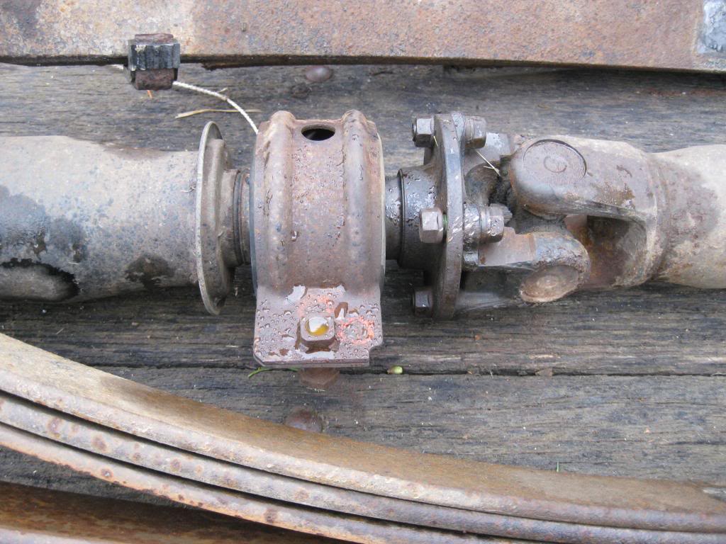

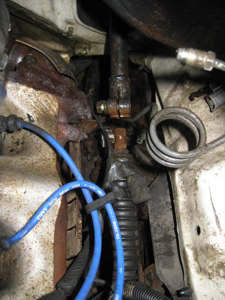

...the rusty splines on the three part drive shaft. Using a copper drift on the clamp, I drove the middle spline into the upper most steering wheel spline - there was room in the socket. As for the rest of the cab it was hoses, hardlines, and electrical plugs.

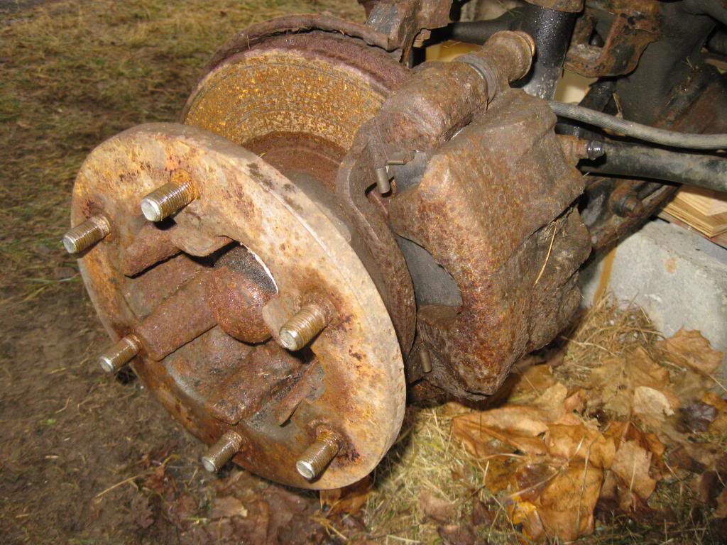

Ignorantly, I assumed that I would transfer the front's calipers to my 4-runner, however, they don't match vendor images or manual illustrations for V6 calipers. Beefy.

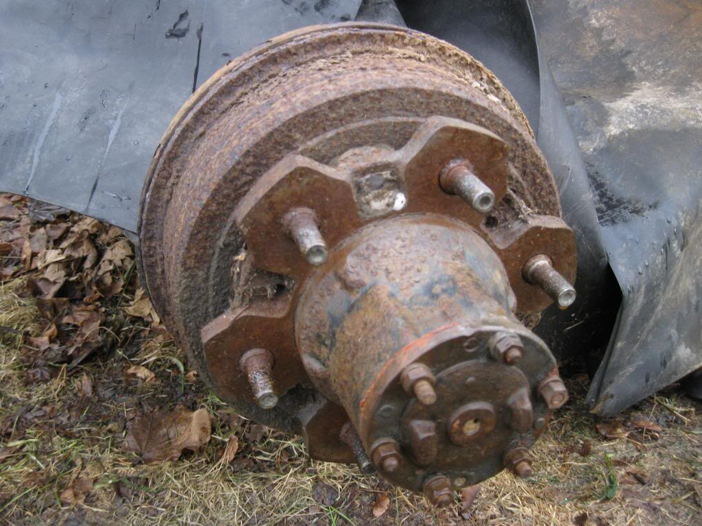

The rear hub looked bass-ackwards but gets simpler the more I study it. A cool feat to get two wheels sandwiched together-one dished inwards over the drum, and, the other, outwards. Both convex wheel surfaces held on the plate by one set of studs.
