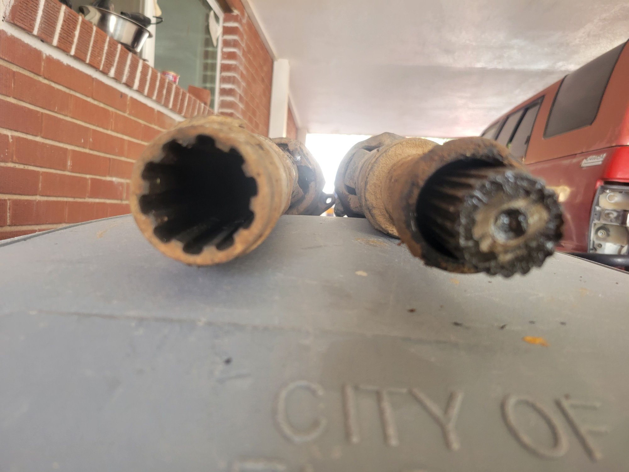

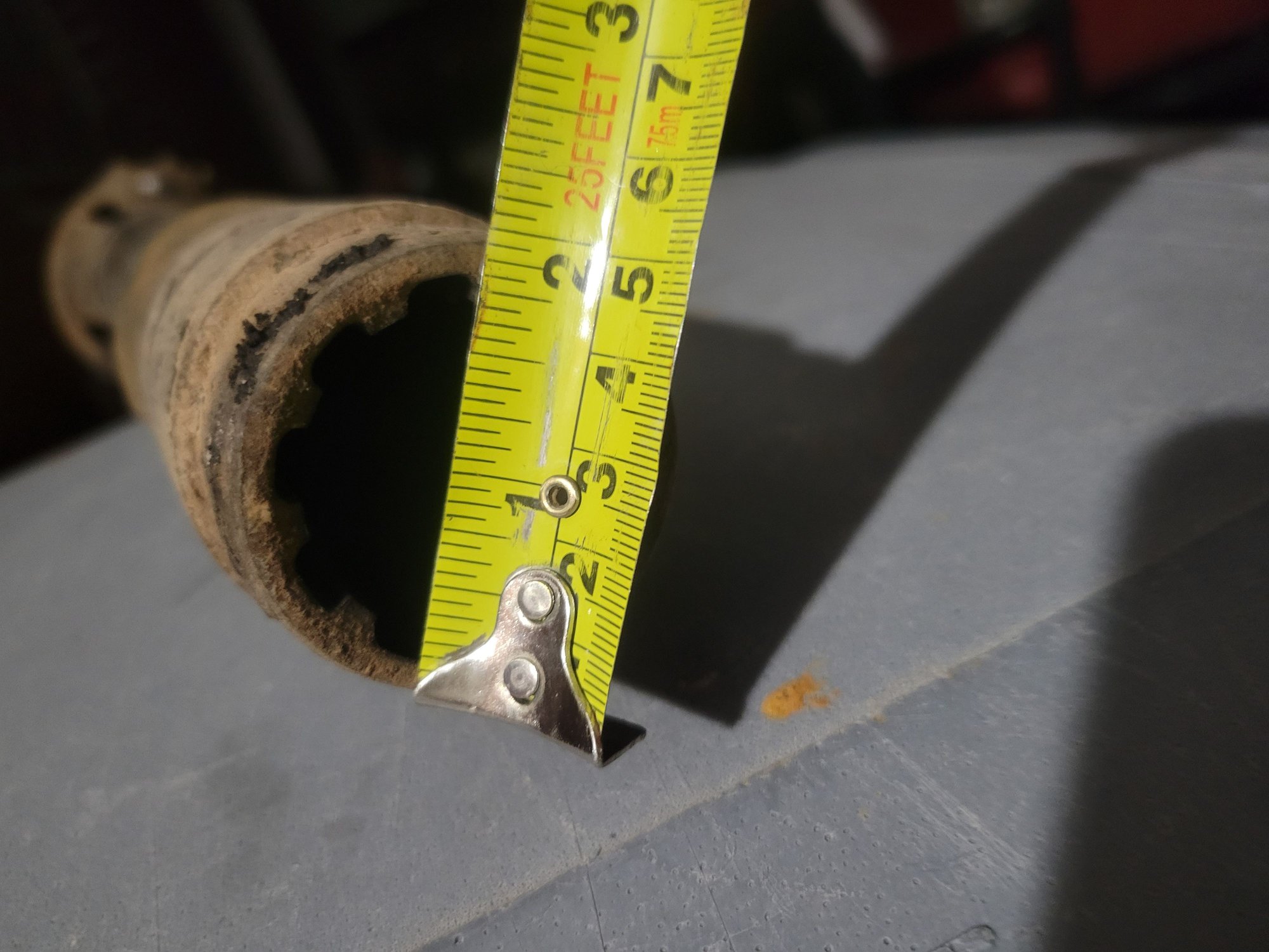

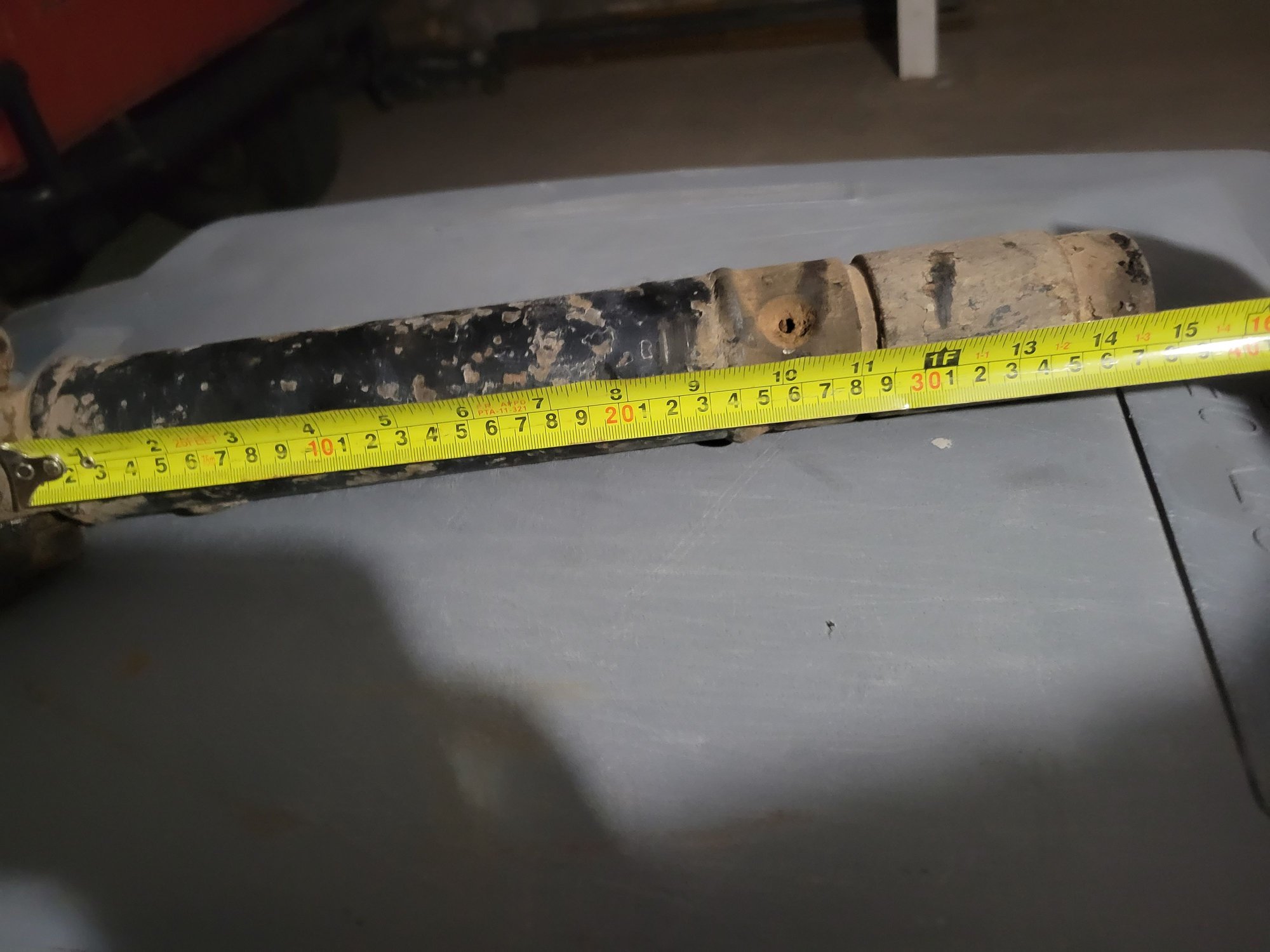

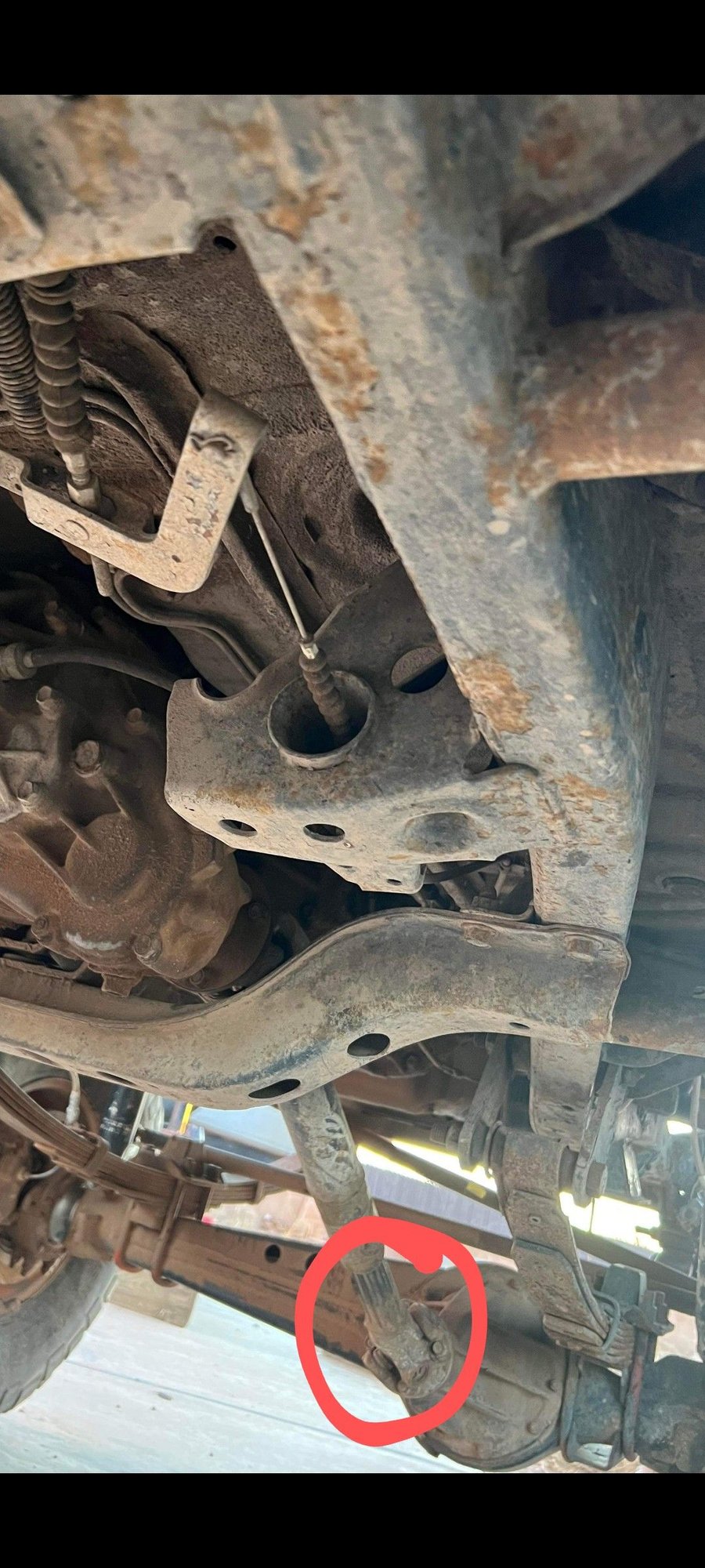

I got an 88 4runer SAS. I think the front axle came from an fj. It's lifted 6". My front shaft broke and I lost half of the shaft circled in red. Can anybody help me identify that shaft? Where can I get the missing half?
Im looking for the shaft on the left. The one on the right is the OEM shaft:
Any ideas where can I get this shaft or the half Im missing?
Thanks!!!

looks like a pretty steep driveshaft angle. Maybe try Martin crawler for some ideas.

Looks like a long travel spline set you can pick up from trail gear or marlin, but it would have needed to be welded together and balanced. I would get with your local driveshaft shop. A lot of the long spline shaft parts are agricultural parts
