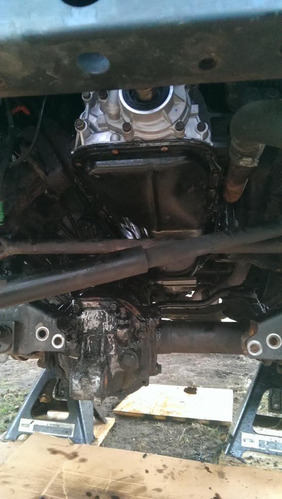

Wow. It's been COLD. Needless to say I have been a pansy when it comes to wrenching in the cold... in my defense it's been dark every day when I get home and my weekends are busy. Also since this is an extra truck I'm in no hurry and I would rather enjoy this build then stress about it.
Anyway today was warm and sunny. All I had to deal with was my backyard turning to a mudpit so I decided to accomplish something.
Pulled the front crossmember, dropped the diff and replaced my oil pan gasket.
It was all a headache as usual but I'm glad I did it. The remnants of an old blown set of timing chain guides were still in the pan from who knows how long ago. Who knows, maybe some of the plastic did its usual deal of clogging the oil pickup at some point and that's why the old top end got oil starved. At any rate it's all good now, I have a new gasket on there and things are getting considerably cleaner as I go along.

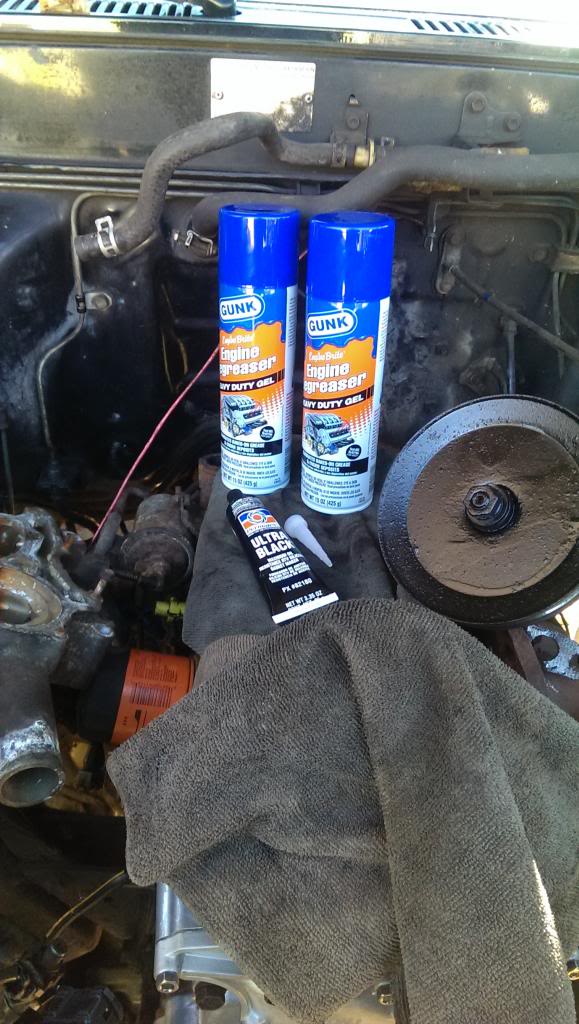

I'll also throw out a plug for this stuff:
I saw it mentioned on a recent episode of Roadkill and thought I'd give it a shot. Seems to do the trick, I went for the heavy duty stuff and it removed a lot of baked on grease and dirt. A lot of my suspension and frame parts should be ready for some paint before too long thanks to this
