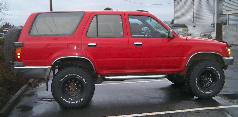

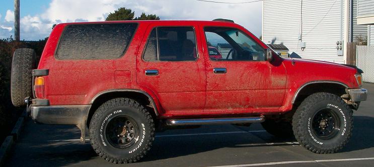

Same travel as before...maybe a little more. Not much more from an IFS setup. I'll let you decide for yourself. First pic is stock. Second is with 31x11.50 tires.

thanks....pictures help. nice truck
