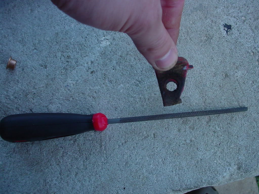

13. File, drill, or grind the hinges to fit the new pins and bushings. Notice that not all of the holes are the same size, check the fitting often.

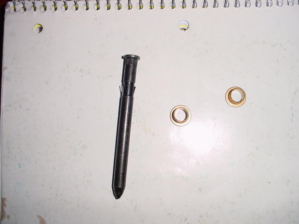

15. Install new bushings.
16. Install new pin.

i put the part numbers in the write up above but here they are
pin 19183
bushing 14550
Old May 9, 2009 | 07:37 AM
