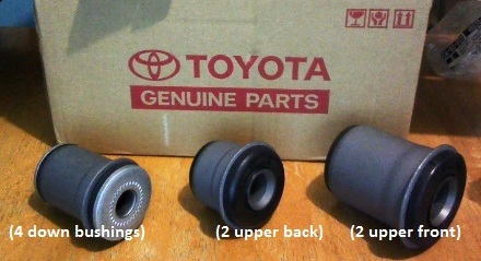

Oem
...Did mines originals...
...expensives...
...had to buy them separate...
...took me about 3 months...
...No complains...!!!
Attached Thumbnails DOES any one have URETHANE CONTROL ARM BUSHING THAT DON'T SQUEAK!!!-feb-2011-copy.jpg
