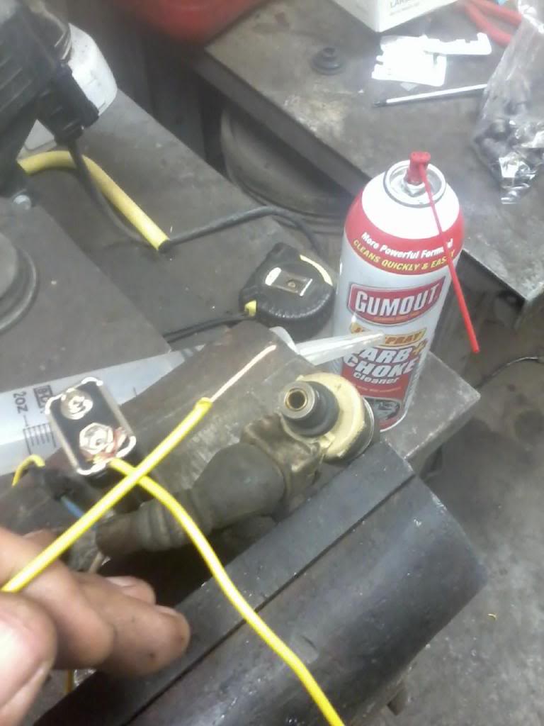

I use a vise and I have a connector from a junk harness that helps me do it by myself. I dont know the exact pressure I am applying but I would say it is quite a bit. Also I run the hose from the syringe and make cleaner flow the oppisite direction in the injector. I found this test on a Youtube or Google search somewhere and so far it works for me. I am missing the rubber hose in the picture but it is to adapt from the syringe to both ends of the injector.
I only apply power for 1-2 seconds at a time when I flush and test to see if the injector is working, You know electric better then I do but applying power for longer then that, I would not think it would hurt the injector. For your test, you dont really need the power of the battery. A cheap tool that might help you determine if you have a leaky injector.

You also mentioned that it could be other issues. I wonder if your EGR could be stuck open causing some of the soot? I have solved a lot of problems on trucks by tearing the Intake down and cleaning all of the carbon out, getting the EGR operational as it will get clogged full of carbon and not operate, do a complete tune up with OEM parts, adjust valves and set timing per manual. I refer to it myself as Clean, OEM parts, and Timing. Also while you have the Intake off, clean all of your other sensors, especially the ones that are in contact with the cooling system. I have fixed many trucks that way.

Terrys87 -
It looks like you and I have the same test set up. I used this a while back when I replaced a head gasket, and all the injector seals and connectors.
I held the syringe in my fist and pressed down on the plunger. I didn't do a measured test, but I don't think I can push my thumb down with more than 5 lbs-force, and the diameter of the syringe is large enough that I don't think I got more than 5-8psi on the injector. (instead of ~40psi) As a result, I got a thin stream of fluid (paint thinner) rather than a full spray. I was happy with it for testing that the injector cycled, and it was an easy way to push paint thinner through the injector, in both directions.
I don't think this setup would show if my injector is leaking now. When I switch off the pump, the pressure drops quickly from around 40psi to just below 20psi, where it sits for quite a while. If that test is showing a leaking injector, it looks like the leak stops at around 20psi. So my hand-powered injector tester wouldn't show the leak.
