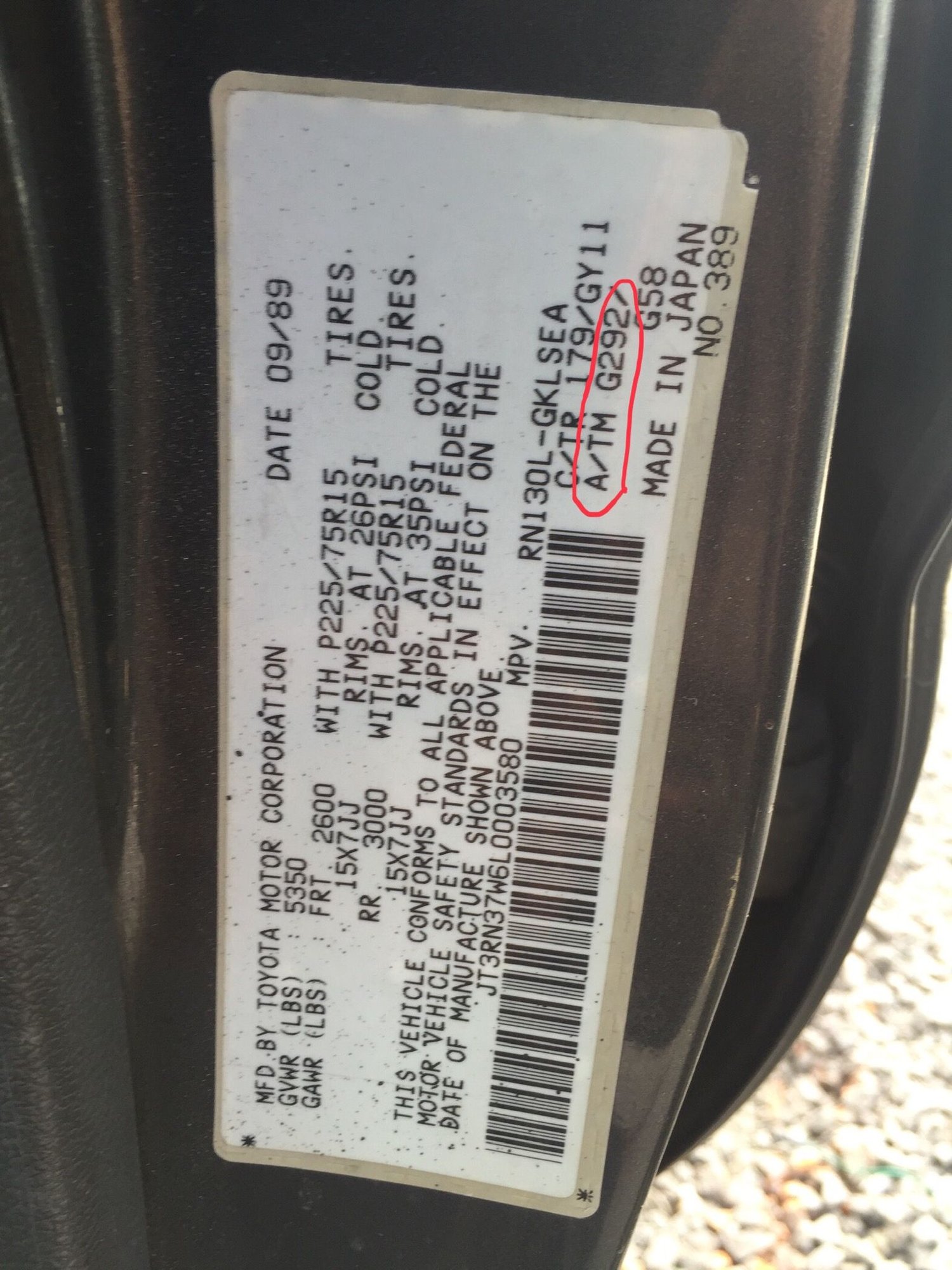

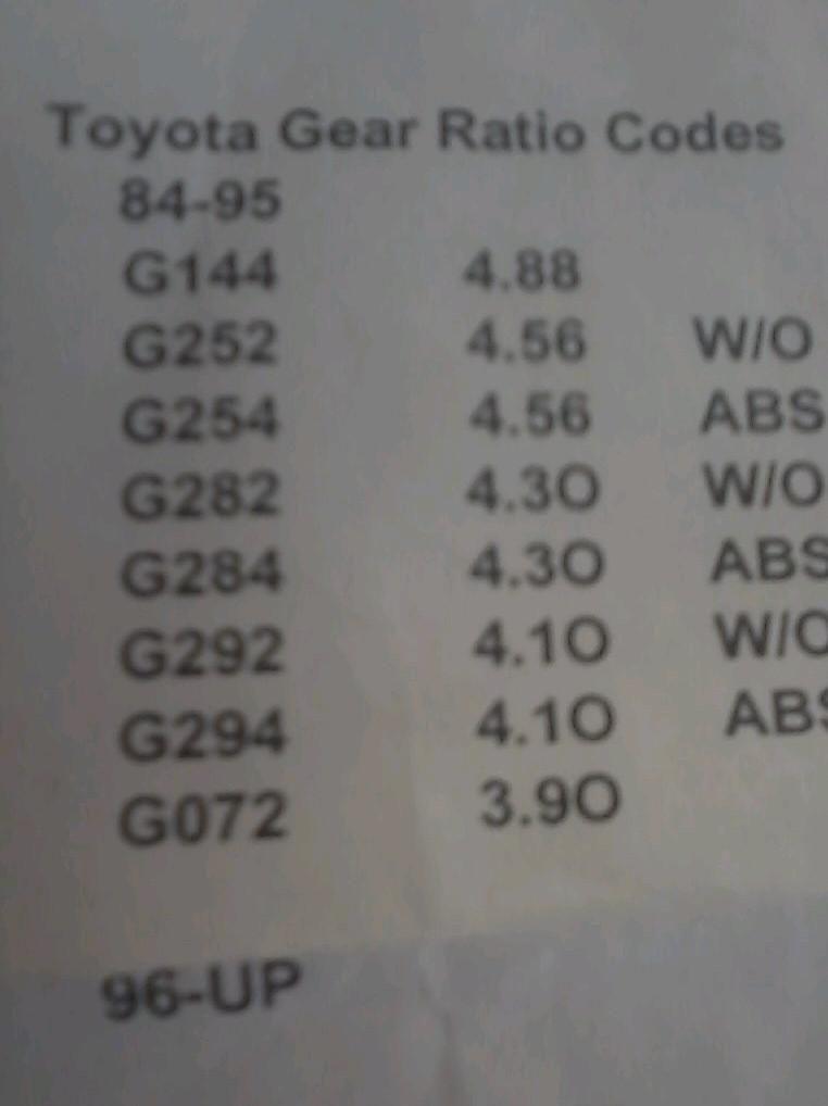

Codes are in the door jam. This obviously only applies if the vehicle has been left stock and the tag in the door jam is still present.

Awsome info , but mine is a 91
Edit , i gotta read more closely lol
Gonna check later , see if the stickers are there

I'll go out on a limb and say your manual has 4.11 and the auto has 4.56
If you have a factory trailer hitch (towing package) and the 31" option, you might have 4.88s

Driver (automatic) matches this one with the 5 speed :-) Looks like i scored very well for 300$ :-)

The 4.56 (code G254) was stock with the V6 5-speed with 31 inch tires. The door sticker may not indicate 31" tires - they were a dealer add-on to get around some import taxes. The vehicles shipped with smaller tires and then the dealer put on the 31's. Gearing was set up at the factory for the 31's. (A lot of these vehicles had dealer installed air conditioning for the same import tax reason.)
