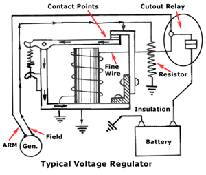

It's a little easier to see with an old-style electro-mechanical regulator.
When you turn the key to on, current flows through the alternator field, but there is no output voltage as the rotor isn't turning. As the alternator spins up, the output voltage rises. In the regulator, that voltage is applied to a "relay." When the voltage hits the target (somewhere around 13.9-15.1v) the coil has enough current to pull in the armature, opening the field circuit, which cuts off the alternator output. The voltage sinks, the "relay" releases the armature, closing the contacts, and re-energizing the field. The cycle repeats. If that fine wire in the coil breaks, the armature doesn't move, and the output voltage just keeps rising. Same when the contacts "weld" together. Modern regulators use FETs and IGBTs, but the operation is the same, and they can still fail "closed" where the alternator just keeps producing more and more voltage.
Of course, there are other ways that parts of the charging system can fail where the voltage just goes to zero and stays there. When that happens, the alt light goes on, the headlights dim, and 20 minutes later the engine stops. So you appear at the mechanic, who tells you your regulator "failed" and you need a new alternator. But in the case where the regulator fails "closed," there's no alt light, the engine keeps running, and if you're paying attention you might notice that your headlights are brighter. That's a good thing, isn't it? Well, after a month you fry the battery from over-charging, and your truck won't start. You haul the battery down to your local parts store, where they put it on the tester and confirm "Yup, you need a new battery." If you were lucky enough to have the battery replaced by a competent mechanic, he would also check the charging voltage, and he wouldn't let you leave without getting a new regulator (today, usually a whole new alternator). But if you're just Joe Blow down at the parts store, you put in that new battery, and curse the crappy parts you get when that battery also dies in a month.
This might be why some people think regulators can "only" fail open; it's obvious when that happens, but less so with the common failure of where the regulator never opens in the first place.
Don't believe me? (Why should you, I'm just "some guy" on the internet.) If you follow Toyota's instructions http://web.archive.org/web/201102051.../2onvehicl.pdf , you first check the charging voltage, and if it's over spec you replace the regulator. If it's under spec (less common; such a failure usually means no voltage at all), you check the alternator open-loop output, and if that's okay THEN you replace the regulator.

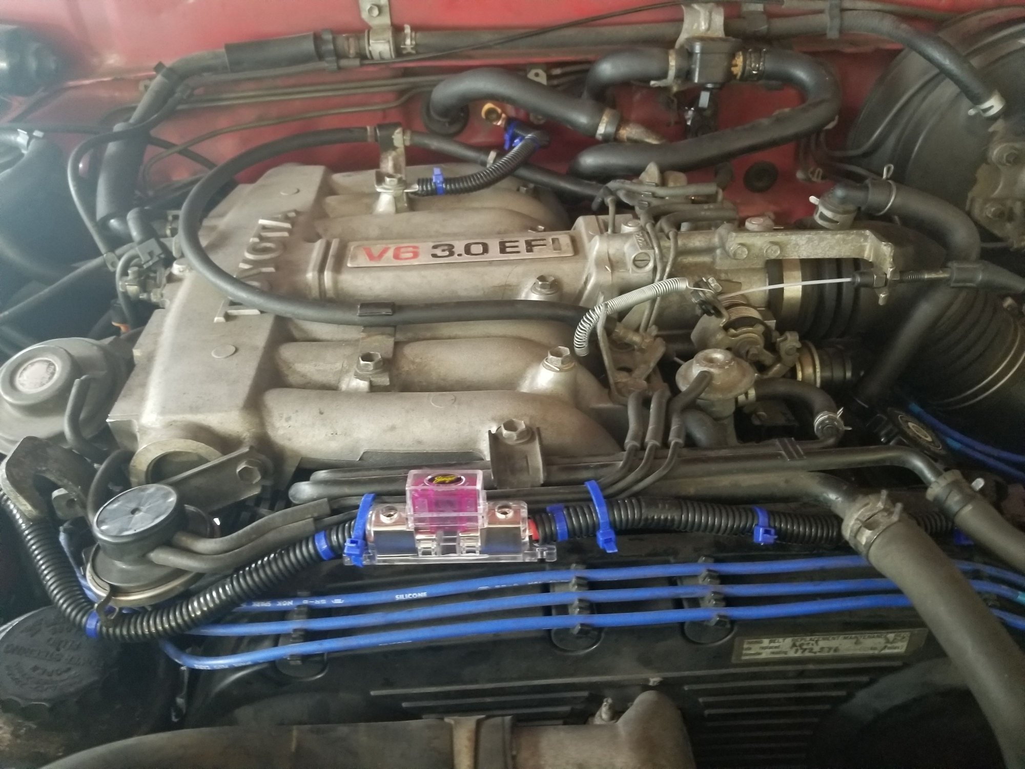

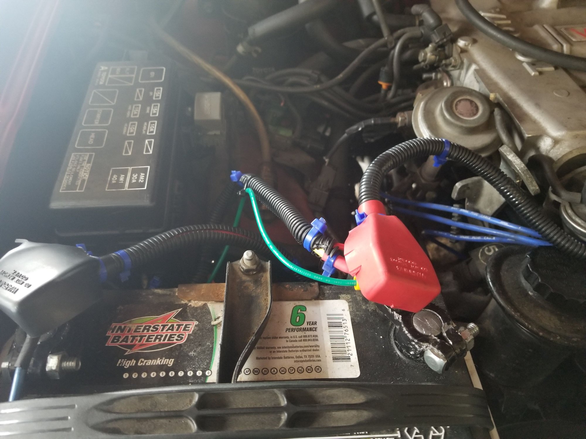

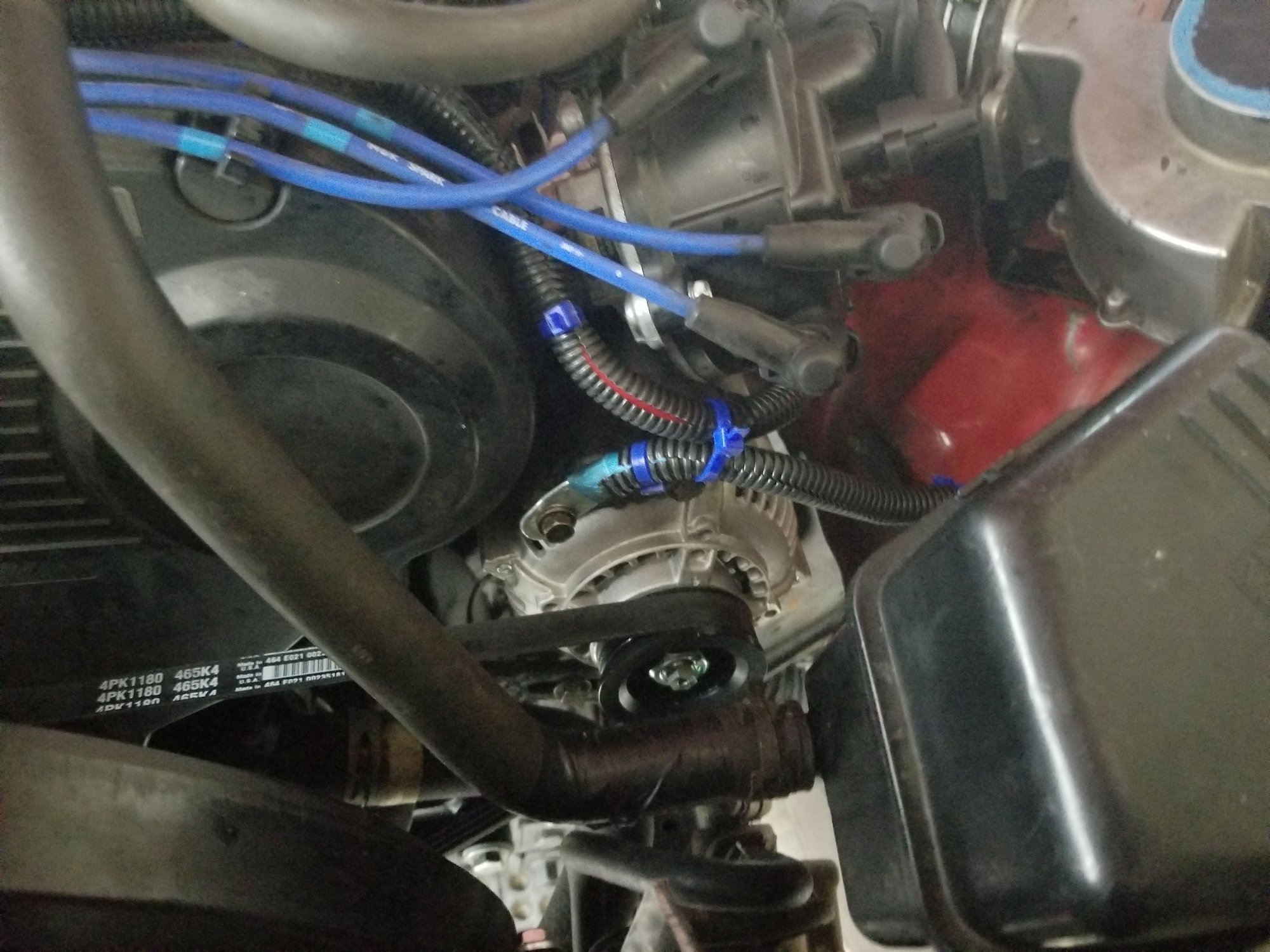

What I did with electrical ground and power up-grade ======
The first photo is the main power cable to alternator all these I did in number 4 wire mostly with heavy duty ends already on from factory and bought them the length to fit where I needed it. I also kept the stock wires in from harness on all grounds and power cables I up graded.. this shows the #4 wire going over motor top to main positive battery terminal with a 120 fuse put in so I can get them at any gas station or parts store! I had a stereo shop install it inline and used blue zip-ties so it shows where I have worked. I also will post picture of ground wire to fender drivers side to alternator mount for good ground....you should also see the plenum to firewall ground redone..
Then I show battery from block to battery ground right over top of stock ground wire. I also upgraded the wire from the relay-fuse box because halfway to battery they had spliced in like a #12 wire from a #8 wire going to box so I made it all #8 wire with heat shrink and covered like all wires I did. I also put a #4 ground from frame to engine block and replace the tiny #12 ground wire from battery to passenger side fender well (only about 6 inches long) to battery with #4 wire I also grinded all areas down to metal and used electric grease on all metal connections. I mentioned in my original post that I also ran a #10 wire from igniter-coil mounting frame straight to battery ground because the igniter and coil both ground through the mounting frame. I also ground the surface and remounted the frame to fender wall to make sure the igniter was grounded good!

Old Oct 15, 2019 | 09:05 AM
headcoach's Avatar
Joined: Nov 2013
Posts: 21
Originally Posted by Yotard
Knowing it's the efan, personally, I would just go back to the fan clutch and get rid of the issue all together.
I thought hard and long on this! One of my friends said the same thing but he has always driven a v8 My original flex-a-lite ran for 300,000 miles without a hick-up the problems I did run into were once goose hunting going through a foot and a half of snow in the stubble field to set decoys up i had to go in 4 low 3rd gear to keep speed up and one of the wires bounced off and over heated the engine I looked down and it was in the red! It was a quick fix and after going back and forth making a long runway to be able to plow so much snow off we went HA.....
Everyone knows the 3.0 lacks power! An E-FAN can give any v6 up to 10 or 15 HP more. It can also help when 4x4 crawling taking heat away from motor a lot better then a slow running belt fan at low speeds in 4 low working the motor hard. my truck has 475,000 miles on it! this is the 3rd motor. the second one I had ported and polished heads - bored - balanced and that is when I bought downey headers - jetted the computer and put in the first E-FAN EVEN WITH THAT MOTOR I have never lost a race to a somewhat stock V8 truck since they pull up next to you and want to race all the time! but that is only out to 50 mph after that they catch me!
This new raptor motor has a lot of upgrades in it including 2 steps up on the cams because the owner told me they went one step up but people couldn't feel the difference so he started doing 2 steps up and I already had ported and polished heads - jetted computer - downey 2 3/4 inch headers - k/n filter charger getting rid of all factory smog crap from California model engine and now with this motor 2 3/4 inch exhaust all the way out the back that we put in almost straight - the only bends are up and over axle then straight out to smitty built back bumpers with a tip facing down and the exhaust above bottom bumper tube for protection when wheeling! The stock exhaust "SUCKED" with all the turns and ˟˟˟˟ and had already burned hole in tubing where it curved around back tire to come out right bellow the back corner panel of bed to get crushed or tore out while wheeling. I also run white water with driftboats for some 30 years and many time have to take my truck out in rivers to put boat in and now My exhaust tip is much higher then stock for not going under water!
All this is important to me! I feel I get the most out of the engine I can with all the upgrades and the E-FAN helps a lot or is a great part of the whole system. I told the engine builder what I had to put on the motor and he said "WOW" it should hall ass. Well when you are running 35 - 12.50 tires even with 529 gears it's still the weak 3.0 slow but I would put mine next to anybodies - well unless that are running turbo's or super-charger ha..... And yeah I have not raced one of the new v8's they are coming out with that have 450 and 500 horse's so I know there are plenty of v8's that can stomp my truck but since that second motor and up-grades they just cant get off the line like I can and through third gear i make ground the whole way on them then I can see them coming and just let off like I already won ,,LMAO... with all the up-grades i should be pushing 215 horses at high r's with this new motor.....I looked into the 3.4 swap with super-charger real hard but this motor was only 2,500 and with a good core back for $500 dollar core charge for my block it was only 2,000 and I just couldn't see going through all this work and putting a motor with 100,000 miles on it which almost all 3.4 swaps do after looking into paying someone to do the job. I'm just didn't think I was smart enough to do a complete swap and super-charger upgrades and the cost was way more then what I did!
BUT YOUR RIGHT! I might have too!!!!!
I bought this truck brand new and have tortured it from crushing the rear axle housing towing rock to tearing off side bar step elk hunting to racing in the dirt to crawling... I had also bought a brand new 1983 Toyota pickup straight axle 4x4 and ran 33's on it with 4 inches of lift for some 300,000 miles on the 22r I'm trying to log 1,000,000 miles in Toyota trucks HA and am very close to half a million with this 1994.... It's mine and it's promised to my daughter when I die so I'm keeping it no matter what! Yeah my buddies have told me just go buy a new truck LOL but this one is paid for LOL ....thanks for the replies guy's I do greatly appreciate it.....

Looks like very nice work, everything sounds & looks right on. Nice to know that what I suspected was correct, and that you fixed a voltage drop problem. No substitute for hard data. I can understand not wanting to hack up the old harness & wires, but if the original wire just isn't getting the job done anymore I replace it. I doubt the original wire still being hooked up & inline with the new will cause you any problems. Your readings show that you no longer have voltage drop from that stock wire. The 4 gauge you installed should be more than enough.
One more small thing. By "electric grease" did you mean Dielectric Grease or did you mean Electrically Conductive Grease? There is a difference and there is a common misconception about the proper use of Dielectric Grease. Dielectric Grease is silicone based and is not electrically conductive; it will act as an insulator instead, so it should never but applied between the contact areas of a connection. It should only be applied once the connection is made & tightened, to protect the connection from corrosion & oxidation. Electrically Conductive Grease, also sometimes known as Silver Conductive Grease, is carbon based and has silver particles in it. It is not normally used in automotive applications.
