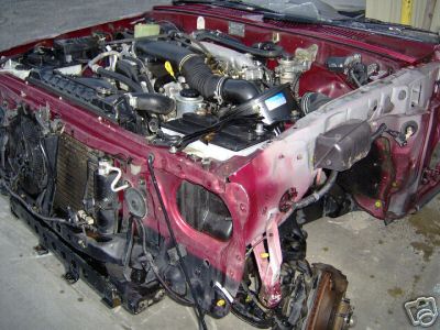

Ok, another diesel conversion is now underway. I will try and keep everyone updated as it progresses. My half-cut arrives next week and so now the painstaking task of disassembling the 3vze is now underway. The first two pictures are the donor factory diesel engine/transmission from Japan. The second is the truck it's going into. Factory toyota diesel baby!!!

I am using what's called a 1KZ-TE engine. It's a 4 cylinder turbochared diesel engine. Completely computerized and it makes about 150hp and 220ft/lbs torque. The cost is about $4000 delivered but I'll also be getting about 25-30 mpg. The unit comes complete with transmission and all wiring etc. Basically the entire car from the shifters forward. You can get a chip for these engines out of australia to bump up the power to about 200 hp and 300 ft/lbs torque. From those I've talked to that have driven them, this engine will keep you pushed into your seat until the o/d kicks in. Here's a link to my engine running before it was cut in half.

Yes, manual transmissions are available although more expensive. The only difference in those and the w56 is the bellhousing (which is interchangeable). Parts availability is not a problem currently. Anything you need, you'll have to order of course. But ordering parts from australia is actually faster than getting them from the USA since everything has to be airmailed. I ordered some parts from a previous conversion and it turned out to be pretty cheap to ship from Melbourne. The clip came as if you walked out into your driveway and cut your truck in half behind the shifters, took the front wheels off and shipped it. The clip starts in the cut state and the a/c even works! Ecu,wiring, radiator,fuel filter/heater everything, even a right-hand drive dash with ash tray We perform the swaps for others on an individual quote basis. Our shop that we work out of is located in Austin, Tx. The most commonly swapped truck is the 89-95 toyota 4x4. Earlier body styles are the same just more expensive to have us do since some creative thinking comes into play when it comes time to wire everything up. Everything is bolt-on on the 89-95 trucks and the wiring is limited to extending the instrument cluster wiring so that it will reach to the left side of the vehicle. As far as mileage, Ithe clip I got has 112,000 kilometers which is around 70,000 miles? You'll be seeing about 25-30 mpg consistently.Oh, there is a less powerful engine available in the half cut for as well for $2400 plus freight. It's not a bad engine and will give approx the same mpg. -Todd
