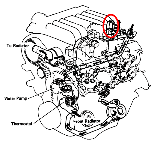

HEYYYY It's a hose!!!! There's a 3 inch lenght of hose that does a sharp 90 right above the exhaust crossover in the rear, after letting the engine sit cold I was able to crawl all over it this morning with it running and sure enough right at the clamp I can see it leaking out.
Still going do an oil change, reverse radiator flush and then a complete drain on the cooling system. WOOO GOOD NEWS!

Hey, don't apologize man, the symptoms where there it just turned out to be something else. That's what this board is for! I've got the FSM diagram of the offending hose, hopefully this will help someone out in the future. After an oil change my oil is definitely black and 100% oil... mmmmm texas tea.
I've still got about a tablespoon of water on engine start from the exhaust, she's just old. Compression test in my near future.
This hose was a NIGHTMARE to remove, 4 hours??? The hose was shot and inaccessible, I ripped it to shreds pulling it off. Had to use a flat tip to bend the spring clamps apart since I couldn't get pliers on them. New generic 90* 3/4" hose with screw clamps. DEFINITELY get a universal joint for these bad boys and you'll be done in half the time.
