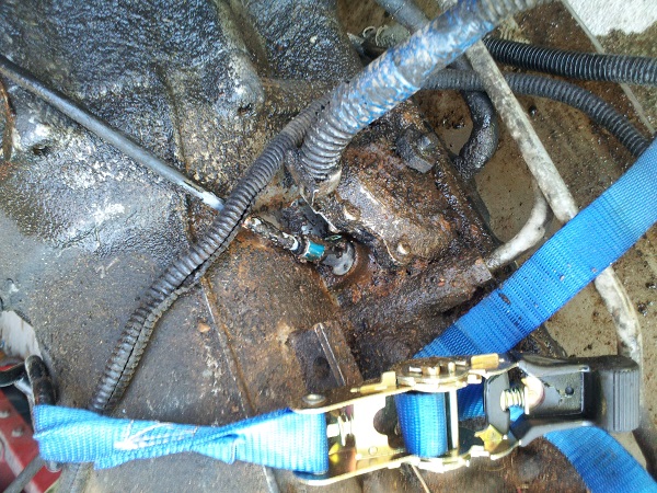

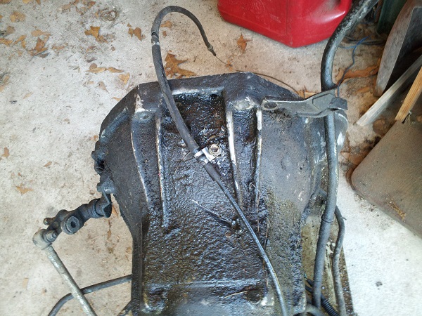

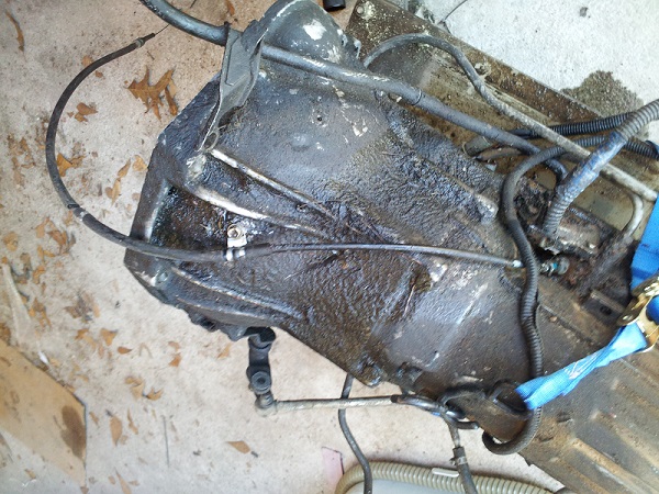

The factory service manual details the cable R&R. It's a 93 manual but it's the same trans and basically the same truck.
http://personal.utulsa.edu/~nathan-buchanan/93fsm/
There is no aftermarket supplier for the cable that I am aware of. I did a good bit of research on it a while back when considering the purchase of another truck like mine. You gonna have to go to the dealer. There are some dealers that sell online for cheaper. But it's going to be faster to get it from your local dealer.
The trans in the pictures is dirty but you can see the cable bracket I'm talking about on the bell housing. In my opinion, it's gonna be virtually impossible to get that off with the trans still in the truck. I also snapped a pic of the cable going into the case.
Good luck!

Thank you Fordless, that helps a lot. I'm like you the transmission will have to be pulled. I can do that alright, and the manual you sent, wow that's great. I'll get on that thing and study up on it to see if the valve body has to be removed or not. Lord willin I'll get it this spring.
Couple more questions: How big a job is it to get the cross member out of the way, or do you pull the motor and take transmission out that way? Can the transmission be scooted back far enough to let the front down then slide it out forward under the motor. How do you do it?
Thanks again Fordless, you've helped me tremendously, I hope I can repay you someday.
