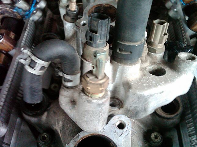

well, i am like 75% done putting it back together, but I broke a sensor so that anyone knows the name or part number so i can look it up online to replace. I dont want to go to the dealer because I know it is going to be more expensive. thank you
Attached Thumbnails Decided to do the head gaskets-img00216-20100329-1150-1-.jpg
I think that is a TVV (1) nipple goes to the charcoal purge, and the other nipple to the throttle body on top, if you don't replace it you will get a gas smell that you will not be able to pinpoint.I know this because I broke mine the nipples get brittle over time with the amount of heat in that area
http://www.ncttora.com/fsm/1990-1995...n/evaporat.pdf
I purchased one off ebay used for $15.00 + shipping and it works great

wow big laughs on that. the same thing broke on mine. I got it switched out with another one on ebay. It knocked the build up back a week but definitely worth getting off of ebay. Yeah Toyota sells it for $85 and I got one that came off a supra for around $15 shipping and all.
