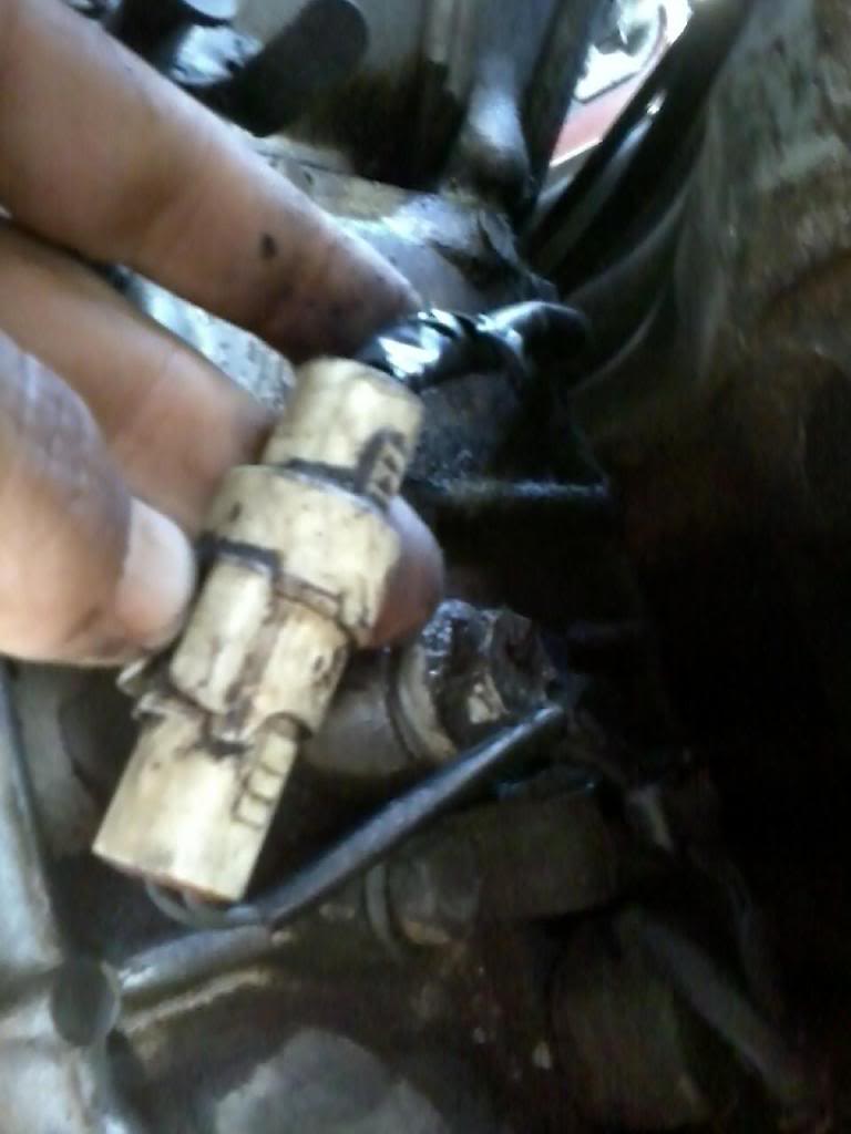

I have seen the Reverse Light cause issues a few times. The connector rubs the transmission and causes the guages not to work. This is just a random fix that you can check. Other wise I have to find out what circuit it is on and start following each wire one at a time.

Check the wires at the back up light switch or the switch itself.
The gauge fuse powers the back up lights
Put a fuse in shift to reverse see if it opens
