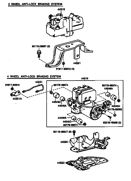

brake assembly actuator
Brake assembly actuator part4510-35010 is the culprit. It is powered by the power steering pump . It could be clogged or the power steering pump is weak.
Part of the anti- lock brakes in your truck.

actuator location
actuator location is under the power steering pump attached to the frame. follow the hard lines form the pump. Usually the pump itself is weak which affects the brakes. I had the same conditions as you describe and replacing the power steering pump fix it.

Thing is that is piggy backed to the Power Steering Pump and only effects the rear brakes .
I know mine has been removed after the rear brakes quit working all together
It really was a strange idea and only around a short time.
Curious how this will play out

On the off chance that it is the rear ABS actuator, which runs off the power steering pump, here is the service manual section that covers that system. There is a diagnostic procedure described that might be of help. Like Wyoming says, the system is a bit unusual, and was only used in the 2nd gen 4runners. They needed pressure from somewhere to pulse the rear brakes, and they chose to get it from the PS pump.

Just another thought. I'm wondering if a check valve has failed between the front and rear brake circuits, such that the pressure from the ABS system is now being applied to the front brakes and causing them to lock up. The "purging" noise you hear could certainly be the ABS actuator operating when it shouldn't.
