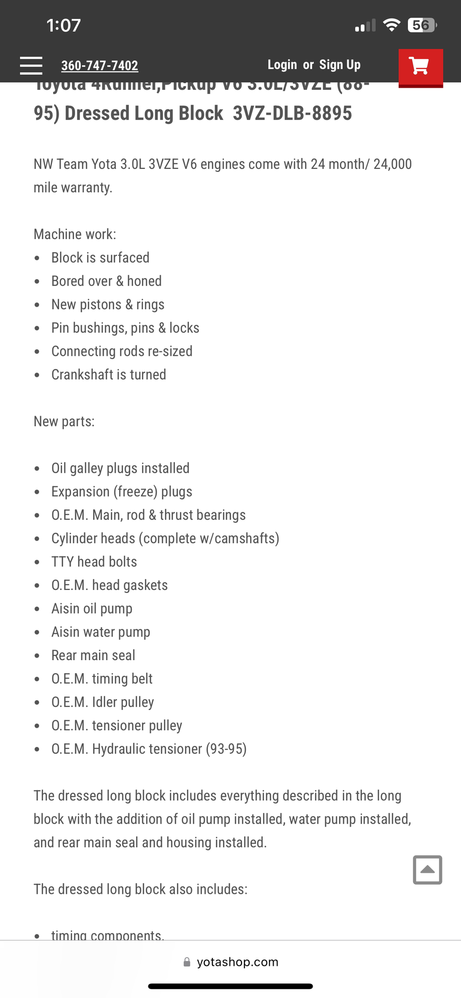

I wonder what they 'replaced' the engine with----a rebuilt or another high mileage engine that ran

direct from yotashop.com

So the engine was new or rebuilt? or is the 5k for engine and install?

this is according to their website.
