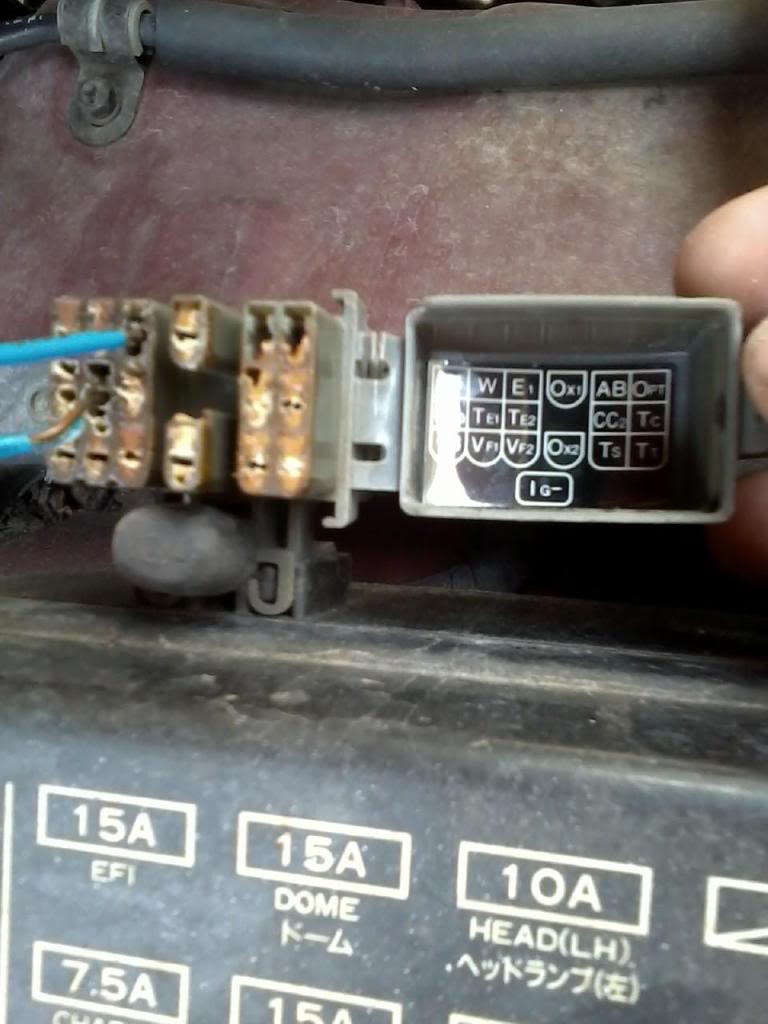

Did you follow the correct procedure to set timing? If you didn't use the jumper, the timing is almost certainly mis-set.
The jumper as in the timing light tool?

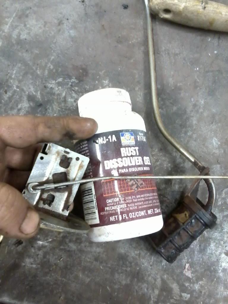

You need to use a paper clip, to jumper TE1/E1 the picture below is for demonstrating purposes with the wire. I dont know the 3.0 but the fuel pump has a filter on the end of it as well and I have seen them get a hard varnish like shell on the end of them that can impede fuel flow.
This picture is from a 22r carburated model but shows the same thing as what could be possibly slowing the fuel flow. The filter on the end of the pickup tube had one area for fuel to get thru. Another problem I see alot of is the fuel system is in bad shape. Return lines clogged starting from the back of the motor all the way back to the fuel sending unit, gas tanks have a lot of nasty build up inside of it. The tank can be cleaned or replaced and the fuel lines I flush with PB Blaster.

I havent worked on a 2nd gen runner in a long time, but under the passenger rear seat, you should have an access panel that you can remove the screws to and get to the fuel pump assembly. A lot of times the supply line to the fuel assembly can be frozen and difficult to seperate. Use caution on working on the assembly as not to kink or break the metal line to it as that assembly can be expensive and hard to find.
You should have enough slack in the fuel lines to lift the fuel assembly out and look at your filter and see the condition it is in.
Uh, no.
Here's the manual. http://personal.utulsa.edu/~nathan-b...13distribu.pdf
Since your timing is almost certainly mis-set (and would be the obvious cause of your symptoms), that's where I would start looking. Not too hard to check.
Long before I messed with the fuel pump.

So update on the truck, I used a paper click to jump the wires (although I don't know how that would make a difference in timing) and set it to 10btdc. As soon as I gave it gas it tried to die on me and make a loud thump sound from the engine and then backfire.

Sounds like the distributor might be off a tooth or more.
Because the ECU controls the advance of the timing it must be jumpered like in my day when you disconnected and plugged the vacuum advance on the distributor to adjust the timing
