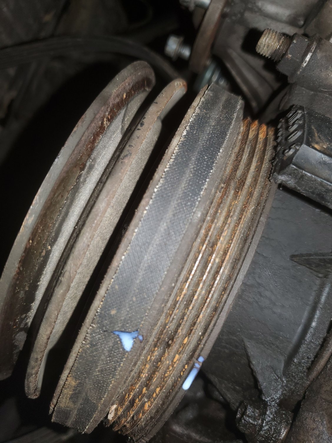

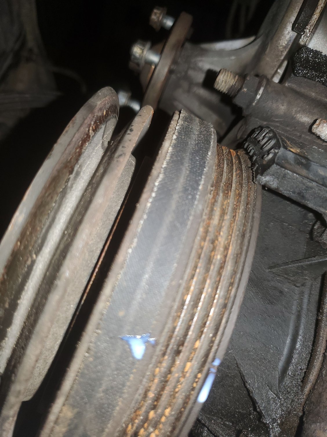

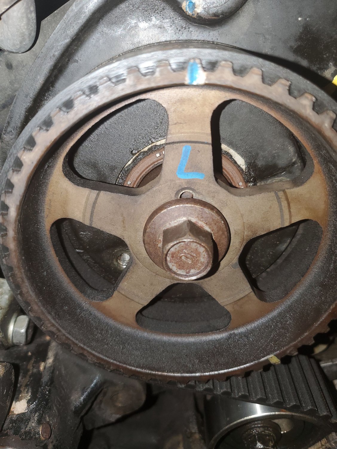

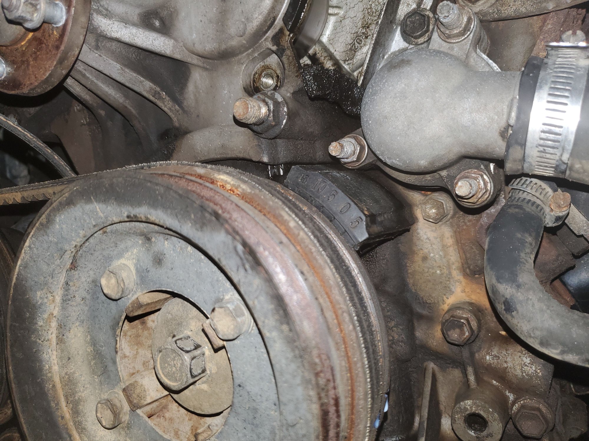

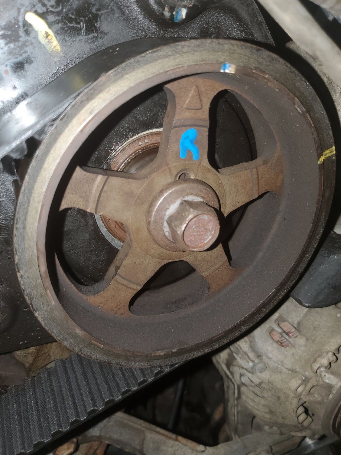

Hi! I am changing my water pump and timing belt on my 3zve. When the motor is TDC both the cam marks line up. The notch on the crankshaft pulley is not lined up with the zero at this point. Motor ran fine before I started the job. What do I need to do? White paint on pulley and is where the notch is.

Just to ask the obvious, I assume all these photos were taken before your removed anything in the valve timing route (belt, tensioner)? (Though, that's a pretty new-looking belt in the photos.)
If it runs "fine" with the crank pulley offset that far, you may have a failed harmonic balancer. There is an annular rubber ring to damp ... harmonics, and at the vintage of your vehicle that ring can fail. The outer part of the balancer (the part with the notch) can rotate against the inner part (the part keyed to the crankshaft).
Just so you know, the left and right cam pulleys are identical; they're just flipped around. But marking everything before you take it off is always a good idea!
