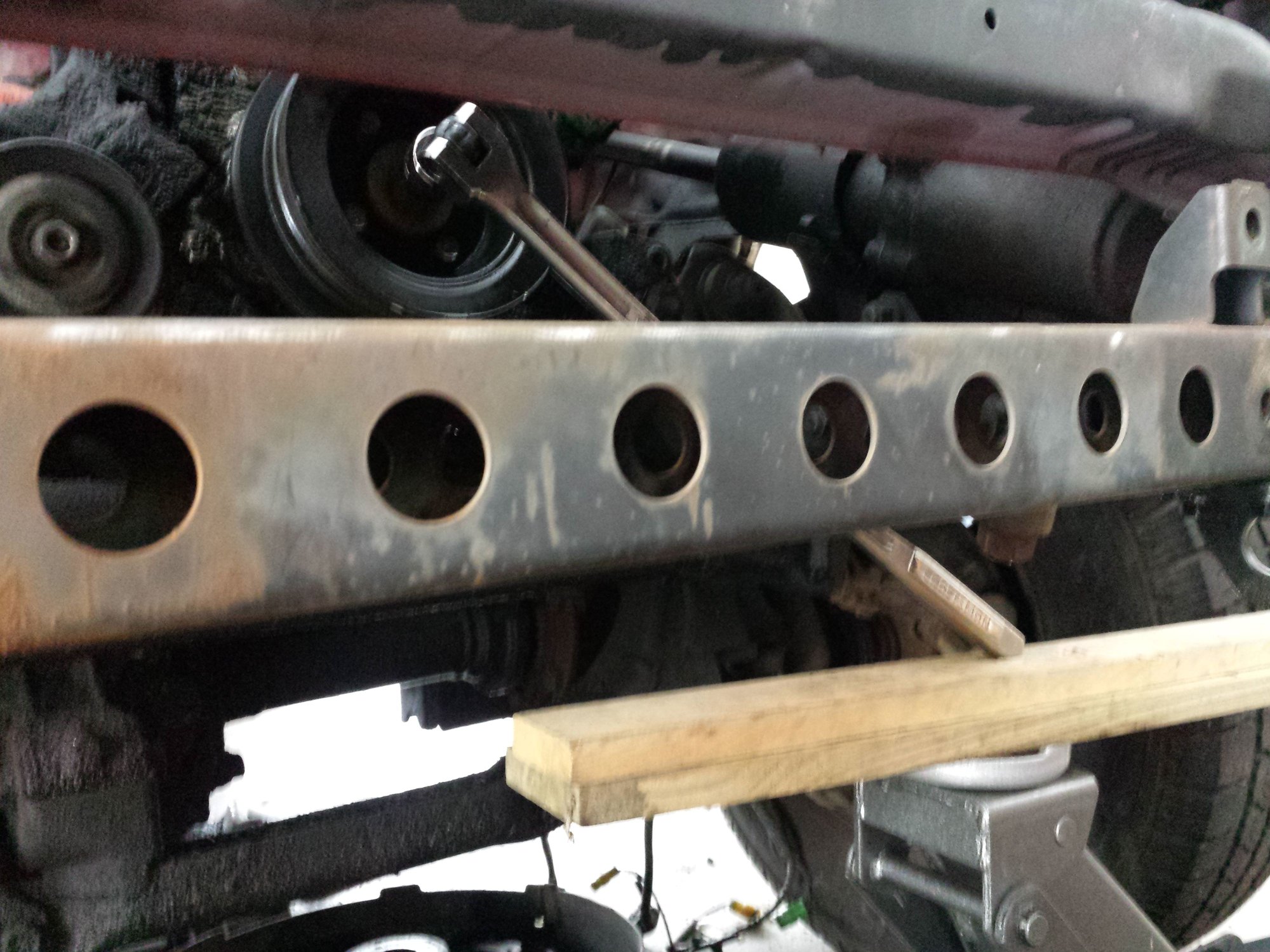

Starter trick
Or
Place truck in 4wd. Place in 5th gear. Chock wheels and have someone hold the brake. Then try this
If that fails then thisis what i did obviously i have to replace the bolt.

That's why i showed the picture of the jack doing the work
