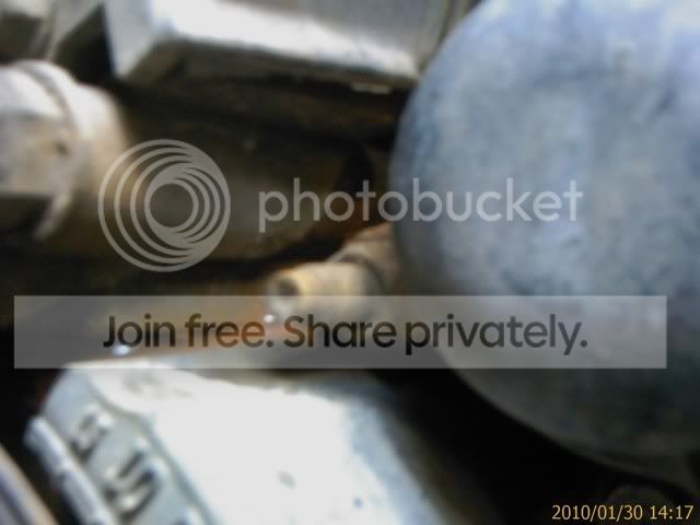

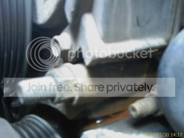

Checked this morning and there is a puddle under my truck . Took some piks of where i think the water is coming from and where the crack is..
So is this a crack and should i be very worried??

Hard to see from the pics, but I think it maybe the water pump that has the crack.

Sorry. Thats the best way i could get my hand and the camera down there to take the picture.
But It just recently started overheating. Can that be the cause??

Sure losing your coolant will make it over heat. Is the cracked part you see aluminum or iron? The water pump housing is aluminum (non-magnetic) where the block (iron) is magnetic.
