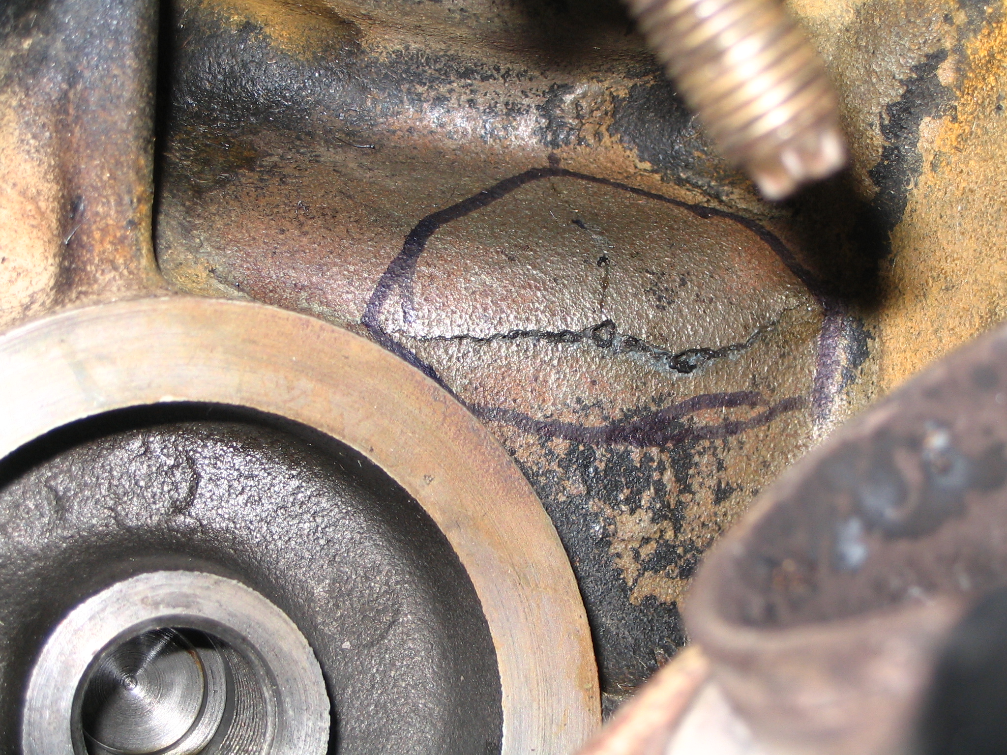

So I found a crack in the block of my newly rebuilt 3VZE. Sucks to find it after getting everything installed and 300 miles on it. It was definitely not there when we were assembling the block.
A friend said that it may be possible to grind it down a bit and use JB Weld to repair it. Any thoughts?

I think the part I'm crying over is pulling it back out again and buying all new gaskets again. I spent a lot of time being anl retentive about the oil pump, oil pan gasket, rear main, etc... There is no loss in it at this point to try to mend it with JB Weld. The plan riht now is to use a die grinder to dig it out a bit and then spray it with brake clean and then heat it up a bit with the propane torch and hit it with brake clean again. Then apply the JB Weld to the cracks. Worst case scenario is still the same if I do it or not. Looking at picks of the block out of the truck and stripped down I can see the crack is well below the water jacket.
I am sure if the rebuilder magnafluxed the engine he would have seen that damage, so he must have only visually inspected it.

So here it is all cleaned up. Next step a little grinding.

Make sure to drill out the ends of the cracks so it doesn't spread.

Pretty sure that doesn't apply here since the forces that caused the crack have been repaired. Too late though, I glued it last night. I will start it up today when I get home. Letting it cure completely.

Sure the rod that punched the hole in the block is no longer there, but thermal expansion and contraction, vibrations etc will slowly spread the crack. Lets hope its slow enough that the crack outlasts the engine.
