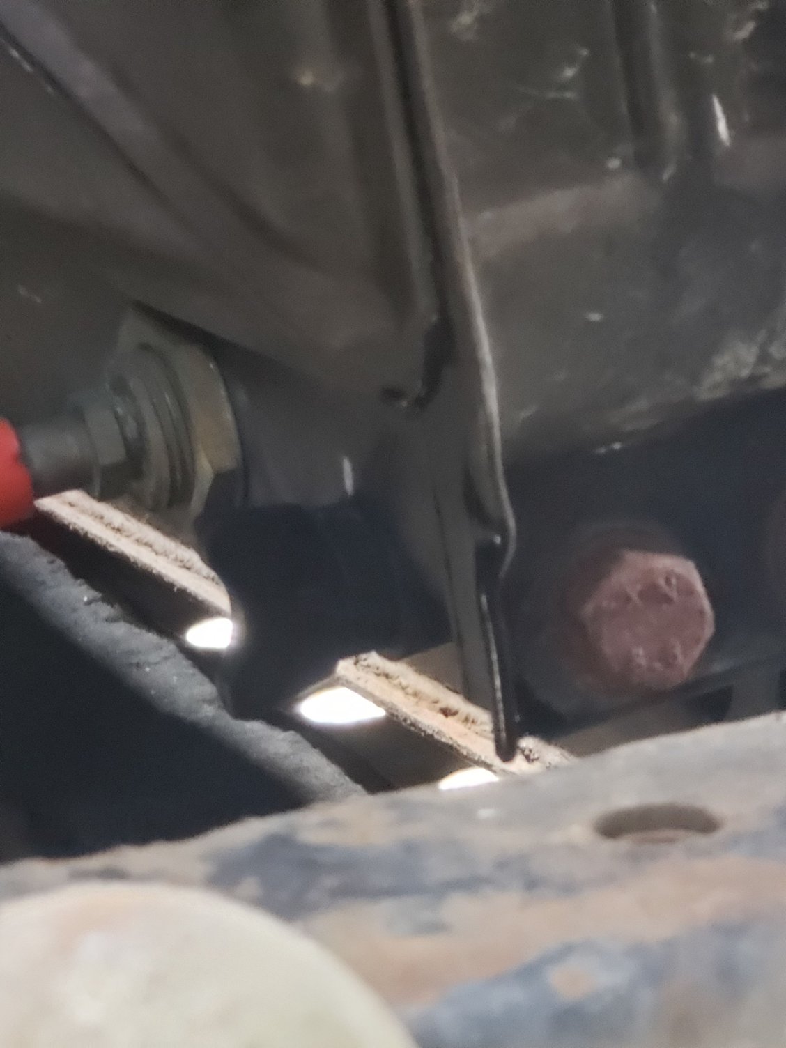

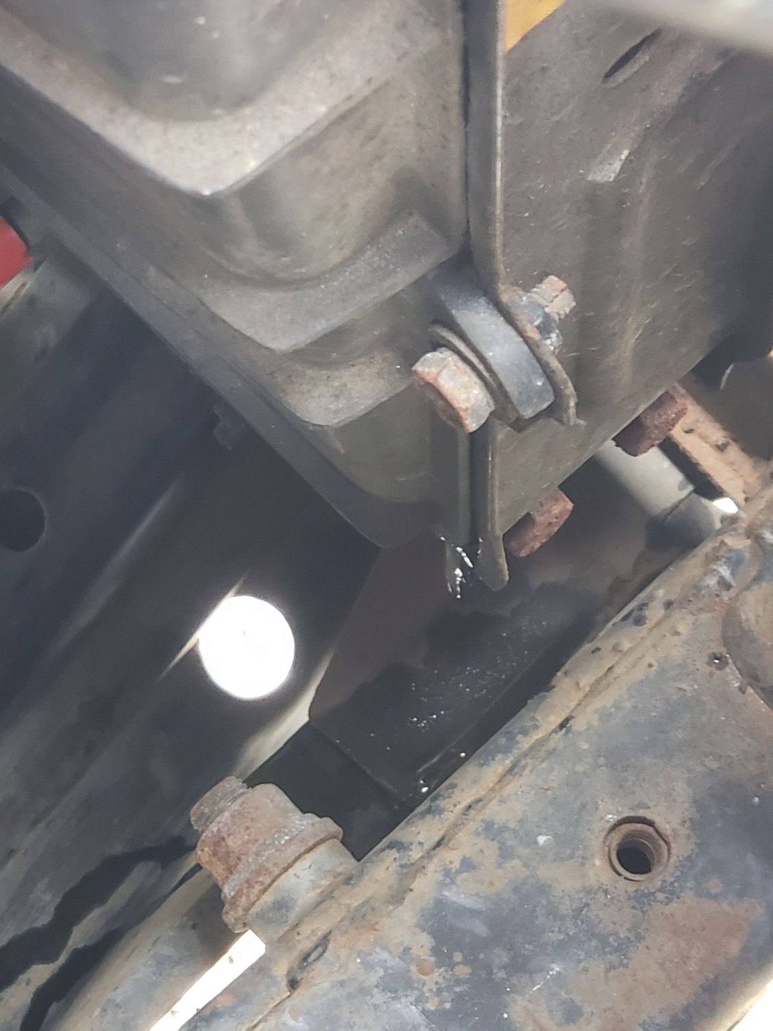

Welp I believe I discovered my problem. The radiator has a slight leak but only when thermostat is opening up. Not the best pictures but it is leaking a little.

Guess I'm going to have to put the yota in quarantine for awhile 😔. Pretty sure this is gonna be the culprit and worse case scenario. Gonna test before I start the tear down.
