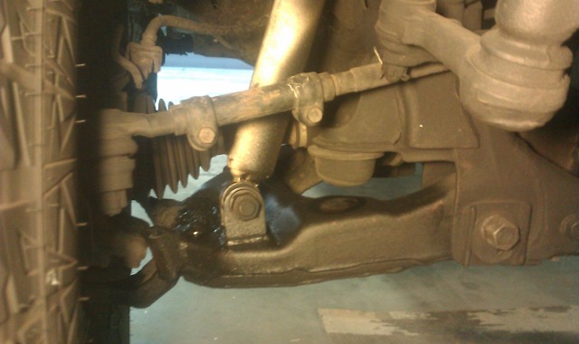

So I was under my truck getting stuff prepped for my control arm swap, and I noticed a nice puddle of oil sitting just outboard of the shock mount. So just the passenge side shock and lower control arm are soaked in oil, nothing dripping from above, nothing else really saturated. Any thoughts? Blinker fluid blowing back from the bumper?

I'd suspect you've either blown that shock, or split a cv boot. Those are the only two things that could really leak down onto the control arm right there.

Well, I'll take either one of those. Replacing both tomorrow morning with a Bilsteins and t100 cv axles. But I'd suspect it's the shock, cause I checked the cv boot and it's fine.

Doesn't look like shock fluid -- it's more of a light oil in my experience.
Could also be a failed inner axle seal -- the one that seals the wheel bearings that you're supposed to replace when replacing axles.

^ this is what i was thinking. If your in there you may as well do the seals for peace of mind.
