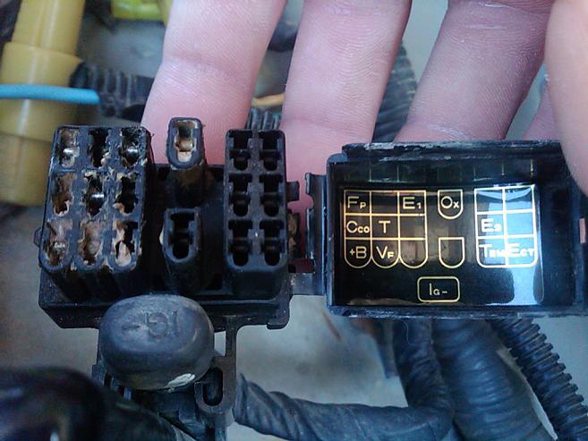

well im not getting any fluctuation of voltage at TE1 and E1 on the diagnostic port. i tested it just like the FSM says to and the voltage stays solid at almost 14 volts and doesnt move.
voltage at VF1 and E1 is 0.05 and doesnt move.
the FSM says the next step is to replace the o2 sensor...but i just put in a brand new NGK o2 sensor...so now what?!?!

Double check you're using the correct diagnostic ports.
For some reason, I think you might want to be using the Ox connection.

im 100% positive im using the correct terminals. mine has a diagram on the cover just like that one.
