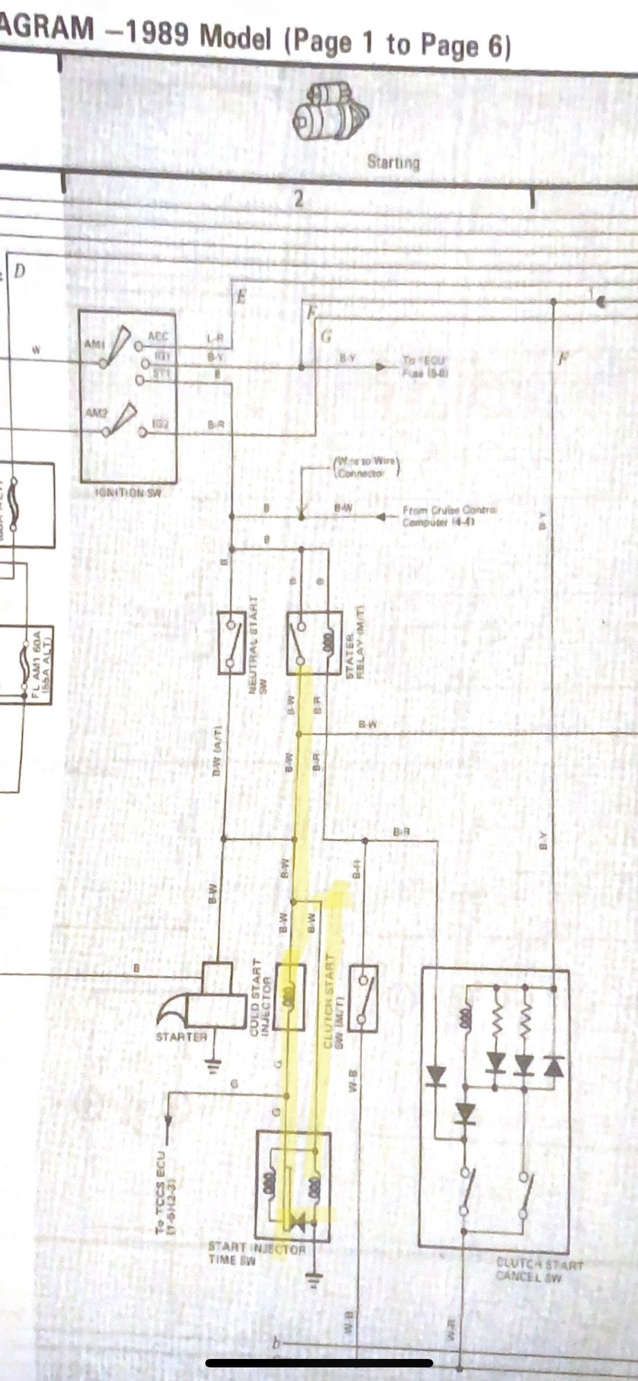

Here is the Diagram I am looking at

When your truck is running, ST1 is open. So what you learned is that both terminals of the harness to the CSI are at ground, which is correct. Look at the diagram; one goes to ground through the first coil of the Time Switch, the other goes to ground through both coils of the Time Switch. Your voltmeter draws (essentially) no current, so the 90 ohms or so causes no detectable voltage drop.

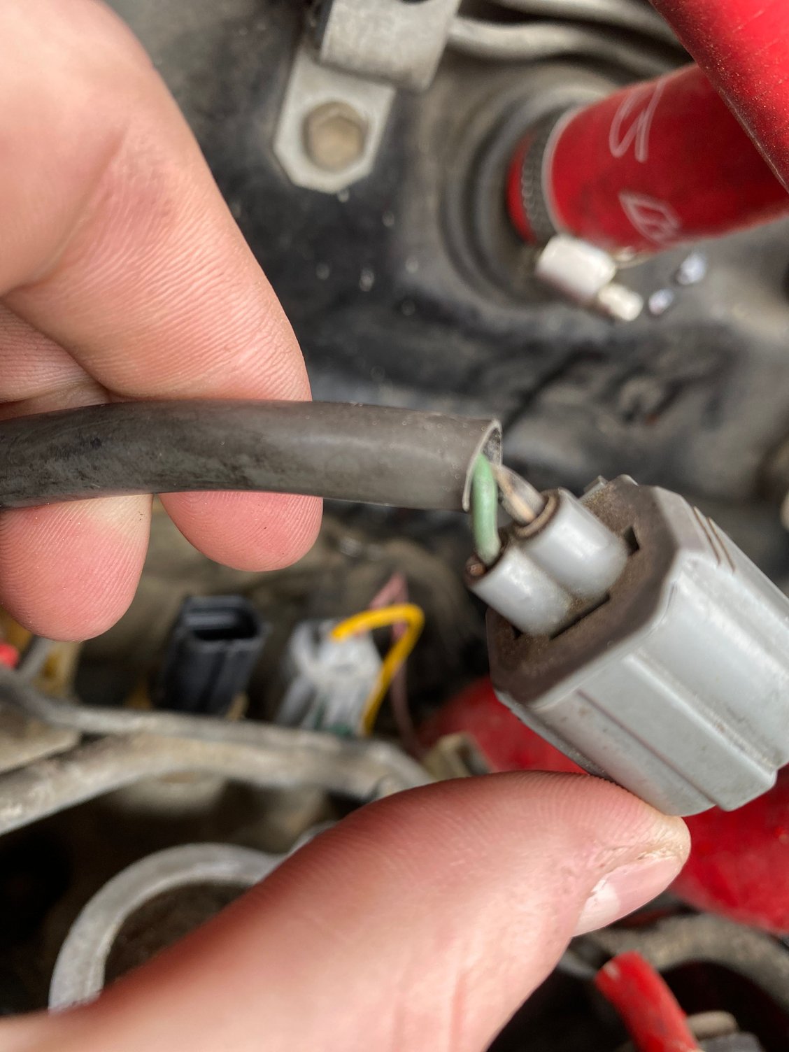

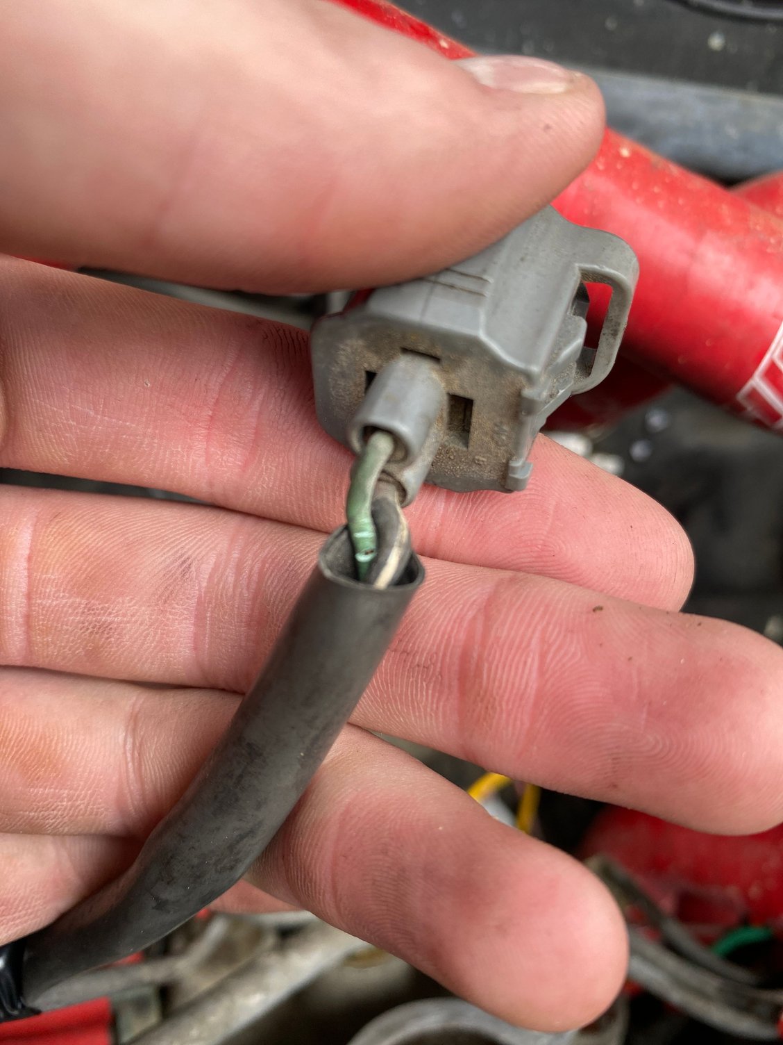

i also pulled the plenum off to inspect the wiring from time switch and CSI. nothing obvious like an exposed wire. however the connector wires look a little dried out
