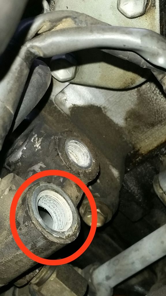

Often times, Toyota components are bulletproof. The problem is in the way they are wired or assembled.
Even IF you have a perfectly-good CSI timer switch with clean threads... the thread in the port where CSITS screws into (see pic below) needs to be cleaned down to shiny bare metal because this is how the CSITS is grounded on the vehicle. I used the steel bush brush used to clean the inner surface of the battery terminal
While you're at it clean all the temp sensors (like I just did):
CSI Timer switch,
Gage Temp sender
ECU temp sender
Bi-metallic Vacuum switching valve (sits on same block but above the CSITS and ECU temp sender)
