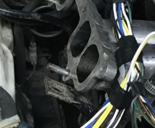

I did want to re-tackle the issue of a possible flooding. it makes sense that if the truck starts and runs great cold then once warm is getting to much fuel then dies. Possibility 1: cold start injector is leaking(even though its unplugged) Possibility 2: coolent sensor next to the cold start injector time switch is giving motor mixed signals.
What to check? maybe pull a plug and see if its wet? Pull intake and see if intake galleys are wet (they were last time I pulled the intake). Ideas? suggestions?

Need more details on the wet intake. "You have to put us in front of the truck."

The picture is of the wet your are concerned about? Looks like oil from here, from the positive crank pressure valve (PCV), fuel would have evaporated while you were doing all that wiring.
