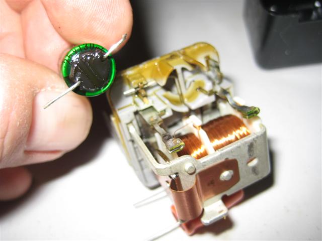

OH Yeah!!! I think I found the culprit.
I removed the Relay when I got home and it was covered with some sticky gunk.
I popped the black top off exposing the innards and the Capacitor inside leaked all over. it is an electrolytic cap that in series with the resistor makes a charge circuit to hold the relay on if the flapper closes for a second while the engine is running. if that cap cannot hold a charge, it cannot turn on the relay.
i took some pictures that I'll post after I'm 100% sure I solved the problem.

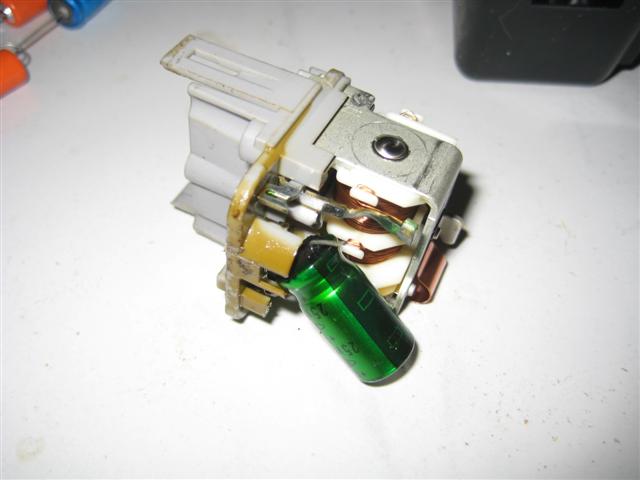

I soldered wires onto this relays 5 lugs and run them to a breadboard so that I can measure the voltages on my passenger seat before during and after starting.
but even at -17 plus a good cold wind the truck started right up without the aid of jumpers. I'm optimistic that was the smoking gun.
on a side note. that Cap is easy for anyone to change. The change can be done with a small screw driver. not even any soldering required.
Its a 15¢ part and Toyota is charging $175 for its effective replacement. Can you imagine?
I didn't have the exact part (130uf @25V ) so I made up an equivalent using a 100uf in parallel with a 47uf both @35V. the little extra will give me just a tad more pump time on after the engine dies.

here are some pictures of the problem.
the green cap leaked its electrolyte.
Attached Thumbnails Cold start...another one.-img_0279-small-.jpg   Cold start...another one.-img_0280-small-.jpg   Cold start...another one.-img_0281-small-.jpg

Here is my fix.
I didn't have the same cap. but the addition of two caps makes a close enough equivalent.
I soldered some cat5 wires onto the relay so I could take some measurements.
today it worked like a charm. Started on 3rd crank but it was only -16deg.
this weekend is supposed to be cold. We shall see.
Worst case is, I'll mount a switch in the dash from Fc to ground and use that to prime my pump before starting. I'm optimistic that I won't have to.
Attached Thumbnails Cold start...another one.-img_0282-small-.jpg   Cold start...another one.-img_0283-small-.jpg   Cold start...another one.-img_0285-small-wince-.jpg

interesting, this is one thing i didnt touch yet, how did u know it leaked? visual inspection? what is the size of these caps u have used?, ill definitely have mine apart and see, what the hell is happening inside.
Let me ask u a question, how is ur ignition coil? every coil i can find brand new or used, basically doesnt pass primary, weird .., does it even makes that much difference?, im guessing it wouldnt really matter if i had a ignition coil like that to fix my cold injector harness cable having power. Anything above 4v is good
Old Feb 1, 2011 | 06:43 PM
Joust's Avatar
Joined: Oct 2007
Posts: 43
See post #13.
and the pictures show the leakage all over the place including the brown stains on the plastic housing.
