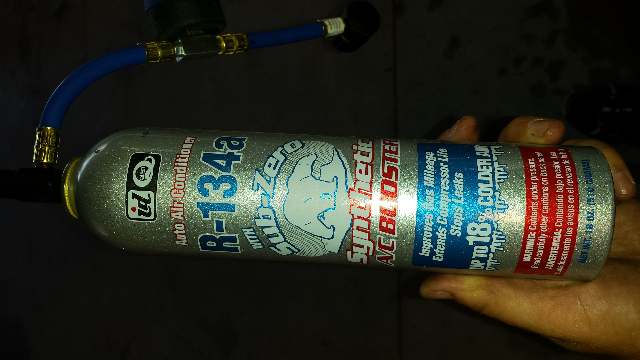

This is the ac recharge I used. When pressing the ac button the light comes on and so does the fan that cools the radiator. (It don't have a fan that attaches to the motor its attached to the radiator and clicks on when reaches a certain temp.) The motor does idle up some maybe a rpm or two. The pressure gauge on the ac bottle was the only one I used. I connected it to the low pressure side and read 0 then filled to the appropriate reading all awhile the truck running and ac on high. Was full disconnected the ac refill sat in truck and felt some cold air but didn't last long. I reconnect the ac refill and the gage read 0.

I recently had my ac system repaired. I went to a shop, paid them a couple hundred bucks to do a vacuum (which is important for a long time dormant AC system!) and upon recharge also inject some dye and add eater (oil). The deal was, I was pretty sure there is a leak so he was gonna fill me up a 2nd time for free. Didn't find the leak the first time, 1st day everything ran well, 2nd day no cold air. Got a re-fill by the shop and kept closer eye on the system, eventually i found the leak to tbe the discharge hose from the compressor. Replaced it, it's been a couple months or more now and it is all good.
In short, you need to find the leak, you can either get a shop to put in the dye or you can do it yourself. But you need to recharege the system meanwhile and constantly keep an eye on all of the hoses and joints until you find the leak. Replace/repair the part that is leaking... You already said once you refilled you got cold air, so the system is working.

Checked out the pump and the clutch does not engage. Pulled the wire and getting 7 volts.
