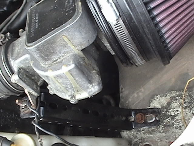

Ok. I just got done installing my custom cold air intake for my 87 runner. I thought I would do I write up for those other cheap mods ppl like myself. I tried searching for a K&N cold air kit and couldn't find one for an 87, but I did find one for an 88. So I thought I could just modify that one to fit mine. If you go to K&N's website, it has most of the instructions listed w/ pics, but I will describe what needs to be customized. *REMEMBER* to search as 88 4runner even though I believe this mod should work for all yota's w/ 22res.
1. Visit K&N http://www.knfilters.com/search/prod...x?Prod=57-9008
2. You will need to order/purchase all of the parts included in the kit. This includes the filter, mass air adapter plate, and misc. hardware.
3. Go to your local Home depot and buy this part: Master Flow Round Duct Cap 6 In.
http://www.homedepot.com/webapp/wcs/...3+90298+502596
4. Go to your local autozone or auto parts store and order this K&n filter: RF-1009 - Replacement Filter
http://www.knfilters.com/search/prod...x?Prod=RF-1009
5. Go to local hardware store and pick up tube of caulk(if you have a caulk gun), otherwise use some sealant that comes in a squeezable tube form. *Optional* can of cheap black spray paint.
6. Now to the installation: Start by unclipping your airbox top. Remove your air filter. Using a 10mm socket, remove the four mounting nuts that connect the mass air flow sensor to the top of the air box. Remove the four washers as well. Now remove the 10mm bolt located in front of the mass air sensor. (Its about 4 inches to the left and 5 inches down from where you removed the nuts.) Now the top of the air box should slide out free. Here's a pic.
http://www.facebook.com/photo.php?pi...8e&id=13720757
Also remove the lower air box using 10mm since you wont need it anymore.
7. Now its time to measure the opening you will need to cut in your new aluminum "adapter". I measured 2" by 2" square centered in the middle of the cap. This proved to be just about right. *REMEMBER* Always cut less... If need be, you can cut more later. I measured the 4 holes for the mass air sensor bolts the same way. I used a pair of tin snips for the big square i needed to cut and a punch and screwdriver for the 4 mounting bolt holes. *Again* DONT make the holes bigger than they need to be. Here's a pic of what it should look like:
http://www.facebook.com/photo.php?pi...6d&id=13720757
8. After you're done cutting up your "adapter", make sure it fits properly and trim if necessary. The next step requires you to remove the rubber gasket from the old air box top and place it onto your "adapter" *WARNING* be careful not to lose the 4 washers sitting inside of the gasket.
9. Once you have the gasket lined up on your adapter, take your caulk and make a bead all around gasket so that no air can get between the outside edge of the gasket and the adapter. Here are some pics of steps 8 & 9. Also, look at the instruction sheet from K&N's website it gives a good pic of the gasket.
http://www.facebook.com/photo.php?pi...11&id=13720757
http://www.kandn.com/instructions/57-9008.pdf
10. Once the caulk dries, you can either put the adapter on or paint it like I did. (See pic) Once the adapter is on and snug tight. Take the filter and supplied clamp and install it with screwdriver.
http://www.facebook.com/photo.php?pi...f2&id=13720757
11. Now that your cold air intake is done, You need to mount it to the body. Using the same hole near the front of the mass air sensor (where you removed a 10mm bolt) and the hole diagonally below it on the body, Mount the assembly with a bent piece of steel. I used a strap piece I found around my garage and bent it at a 90 degree on one end and a 60 or so on the other. I reused one of mounting bolts from the lower air box and found a random bold and nut for the upper mount.
12. Congrats.... You just gained 5.3 hp and it should have cost you at most $65. Thats less than half of $135, which is the best price I saw the K&N kit for.
***NOTE FOR 88 and newer ppl*** I noticed your vehicles have a vent tube going into your air box. To do this install, you will need to cut an extra hole into the adapter for the vent tube. K&N explains it in detail in their instructions online.

I know you think it doesn't do anything but how did K&N prove that a stock 22re gained 5.1 hp? If you dont believe me, read it on the dyno sheet from K&N's website. See: http://www.kandn.com/dynocharts/57-9008.pdf
Here's something about exactly how little 5 hp in on a 100hp engine. Think of it this way, ppl go and spend money on their chevy 350's that have 300hp stock to gain 10hp or so. 5hp on a 100hp engine is 5% gain! The chevy wont even gain 3.5%. I know no matter what is almost retarded to spend lots of money on these 4cyl engines, but here's 3 good reasons why ppl should buy a K&N:
1. Better MPG (seen the gas prices lately)
2. More power (you might notice it, but probably not.)
3. It will outlast your engine. (Completely reusable)
Think about #3. I think anyone that doesnt buy a K&N filter for their vehicle that they plan on keeping is an idiot. After you buy 3 or 4 fram paper filters, you've spent as much as a K&N. And all that time you could have had #1 and #2 going for you. And if you are going to spend the money on a filter, why not pay an extra $5!!!! for the adapter from home depot. It seems like a no brainer to me.
The last thing I wanted to comment on was axle's "intakes are the same for all 22re's." That's not correct. I have owned an 86', 87' (currently), 88', 89', and 94'. The 86' and 87' DO NOT have a tube coming from the passenger side of the engine over the fan shroud and into the upper air box cover. 88' and on DO have this tube.
