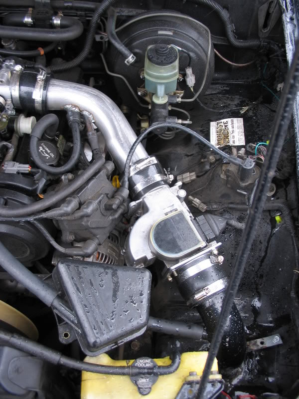

Old Oct 24, 2007 | 08:05 PM
shoes138's Avatar
Joined: Nov 2006
Posts: 553
From: Pflugerville, TX
i still love my design though im gonna change it up!
Old Oct 24, 2007 | 08:12 PM
Mr_Martinez1982's Avatar
Joined: Sep 2007
Posts: 118
From: Bay Area CA
Awesome! and tru "cold Air"!
