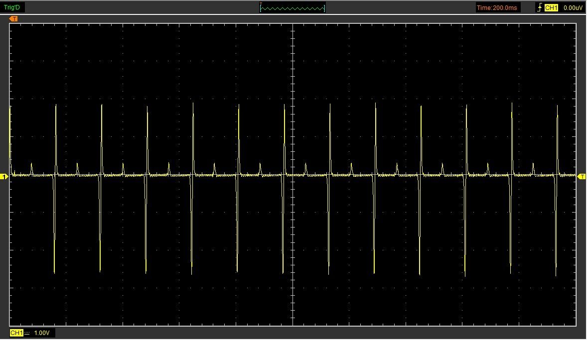

Checked distributor gap and shaft for high play but OK. Changed rotor and took Scope signal with Hantek 1008C (signal pictures attached) for NE; G1; and G2.They look reasonable to me.

At ECM
At ECM
At ECM

The images the OP shows are of the NE, G1 ,G2 signals taken by oscilloscope at the ECU. This means he has good signals and his code was due to "at some point" (most likely..) Not having the dist connected and not clearing the codes..

In the first post we are looking at the signals from the distributor (through the ignitor) as measured at the ECU. Which look OK for the timespan we are looking at. A longer time span wouldn't hurt (so we might spot a missing pulse), nor would having a three channel scope (which let's you line everything up on the same time base, but that's not needed here really it just looks nice.)
