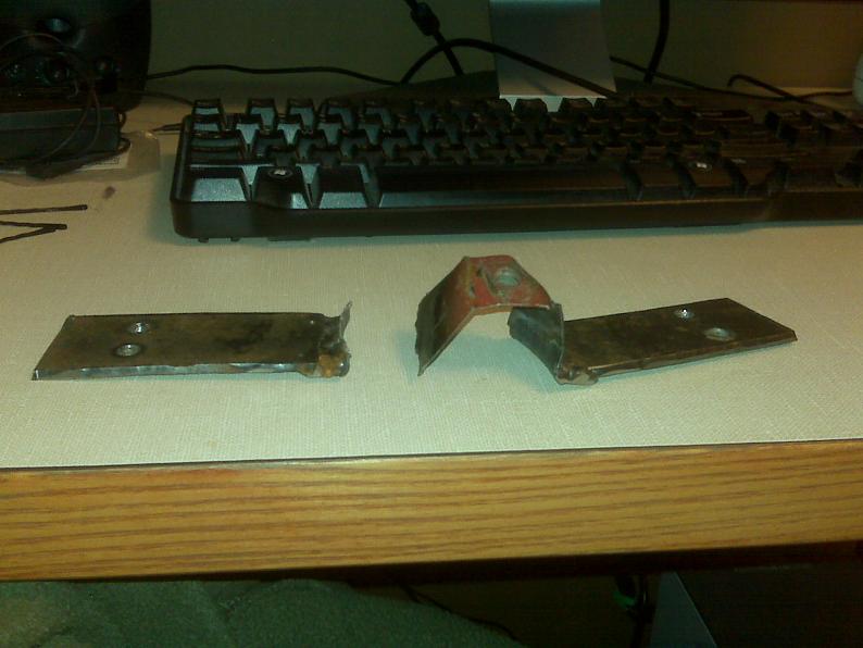

hey guys i have a 91 delux pickup ext.cab and my clutch pedal has failed me i took a pick and it seems the bracket thats attached to the fire wall has broken in the corner so when i push the clutch in it will not engage all the way take a look at the pic can i buy a new bracket or just weld her up and bracket the hell out of it ?

Is the firewall rusted through, too?
You could probably just take it off and weld it, and reinforce it if you wanted to..
But if it's rusted through then the reinforcement is going to be necessary

nope firewalls in good shape how hard is it to pull the bracket i herd its not to bad to take off 4 bolts and disconect some linkages ?

It's time consuming to get out, but not impossible. Mine broke in almost the same place. I'm trying to remember how many bolts there are. I know there are 2 for the clutch master and 4 for the brake master. I think there are a couple others.
Now, you can weld it, like I did mine. If you are going to reinforce it, you might want to put plate steel behind it and weld it.
My understanding, though, is that there is a newer, stronger version of the clutch bracket available, but I'm not sure of the cost. I think I'm going that route if this one breaks again.

theres like big pins or rivits i think holding it down also the bracket for the clutch its self broke would that have a major impact on why im not engaging any gears ???

i had to fabricate that bracket too a while ago and if i did it in 1/8inch metal think it would hold better?

i remember 3 bolts, total..
2 that hold the slave cylinder, and then 1 for top support up under the dash..
This was also in a 1st gen pickup.
I would get the bolt battern off the old bolt on thing, then cut it off, and replace it with some fresh 1/8th stuff.
If it's already rusted, then you're going to end up breaking it again.

Mine broke about a year ago and i just welded it back and reinforced it with a crossmember type bar going across the bracket if i remember correctly.

It's time consuming, as already mentioned, but certainly able to be done with basic hand tools. When you remove it, make sure to check the threaded insert that's facing straight up into the sheetmetal. My buddy's failed this same way, same spot, and the threaded insert had pulled right out of the upper dash/firewall area.
I replaced his with a junkyard piece in a mall parking lot, on Black Friday with a flashlight. It was freezing, and it sucked, but it got him home.
It later broke in the same spot, which is why I noticed that the threaded insert was ripped out. Welded that back in, slapped in a new bracket (I paid about $110 for it or so, but I get a great discount at my local dealer), and it's been good ever since.
