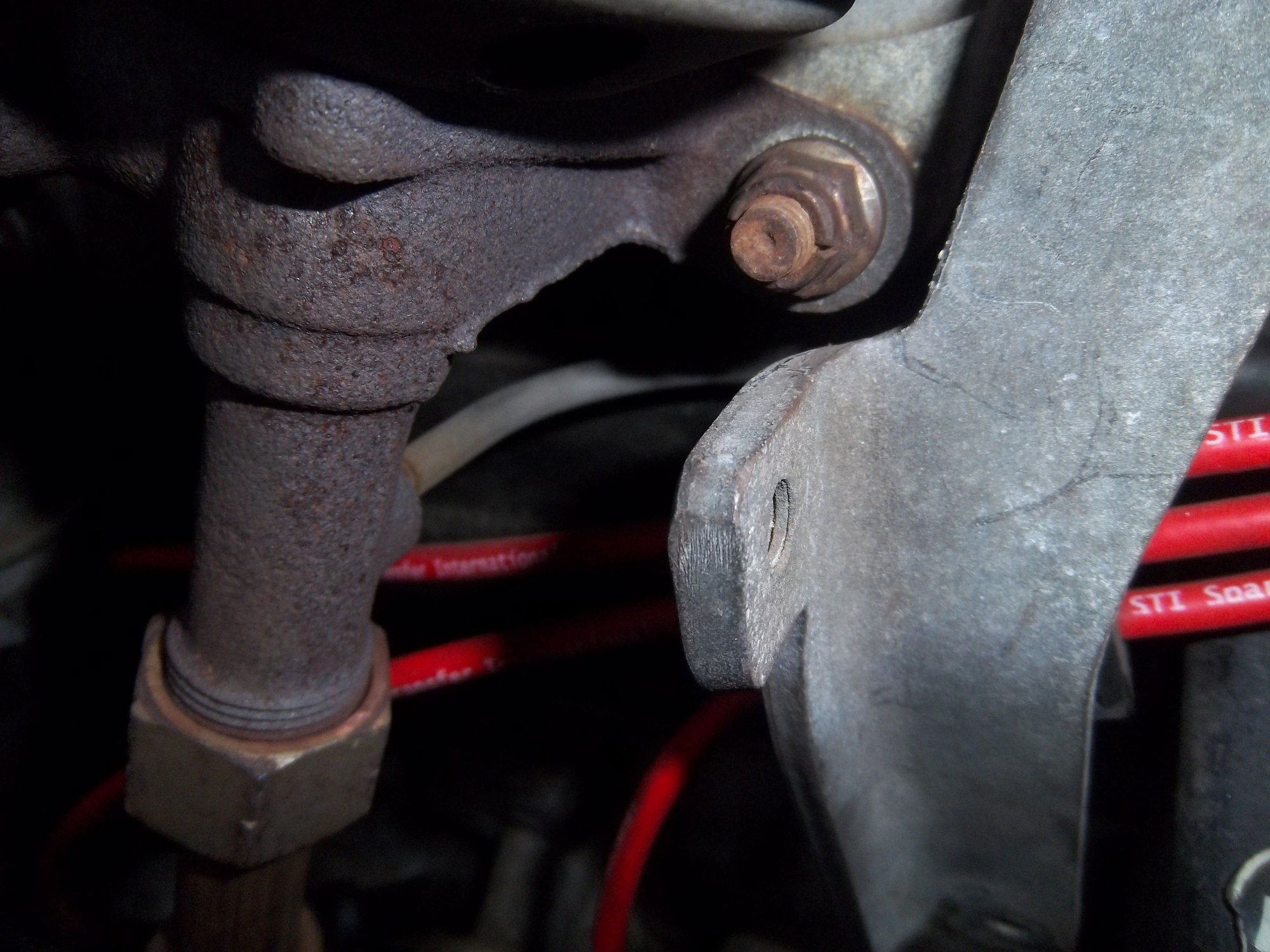

I've been checking here since April 2015, found lots of good solutions, etc. I've done the basic tune up stuff plus o2 sensor, new TPS, new EGR solenoid, new distributor, fan pulley bracket, ball joints, CV axles. I'm about to tackle valve cover gaskets, new injectors. Truck has driven pretty well, but I've always had the 300-500 rpm idle, up down up down. I took EGR valve off for 1st time, cleaned out the bottom tube with carb cleaner, pipe cleaner. And sure enough I'm idling at 800 no sweat, been about a week. Initially this threw code 41 -- TPS. As it happens, to compensate for bad idle, I've had TPS adjusted incorrectly (no code). I adjusted TPS and all is fine. Anyway, this info may be buried in another thread, but I thought I'd share this quick "tip". Truck has 242,000 miles.

You may be having a TPS issue. The "air intake system" has been decarbonized and this is going to kick your idle up When truck is idling at operating temp, loosen tps and and incrementally adjust, you may find a sweet spot where idle kicks down. ldle will obviously go up too depending on position.
The EGR valve tube to clean is the thin silver horizontal tube in picture. It can only help overall.

In a span of 20 minutes I did what's in my original post. Erratic low idling before. Smooth idle around 800 after (I did have to adjust TPS). No other factors at all are in play. Follow where that thin tube goes --- into the EGR Vacuum modulator.
