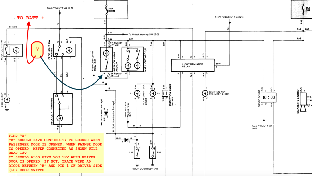

Hi guys, so I've been searching all over Yotatech and can't seem to find an answer to this question. I have an 88 pickup 4cyc, 4wd, m/t, and I noticed that my dome light doesn't light up when my driver door is open (but the buzzer works when the door is open), but the passenger side lights up. What I am trying to figure out is, is there a way to bypass the relay to get the driver side to work? I'm not talking about disabling the buzzer noise or disconnecting the seat belt sensor, I'm talking about removing the relay as a whole and jumping wires on the connector to get the driver side to work again? Thanks for the inputs and help!

The thing is the light operates by grounding when the door switch closes .
There are diodes in the relay will you be installing diodes in your by passing of the relay??
Open circuit between the dome light and and the left door switch jumping things will only fix this if you have also found the open circuit
Thinking about this more if the relay is defective the only way to make this work is to replace the relay or remove it completely getting rid of the buzzer

Well, in that case... do you happen to know if the dome light circuit and door switch run on different circuits? Cause its weird to me that the buzzer buzzes when the driver door is open, but the dome light doesn't come on. Thanks for your input!
ps- If you have a wiring diagram, please post, that would be extremely helpful.

I think you just have wiring issue. I'd rather help you fix/restore your circuit to stock than help you butcher your wiring
(Pardon the capital letters; copied and pasted from my photo edit)
FIND “B”
“B” SHOULD HAVE CONTINUITY TO GROUND WHEN PASSENGER DOOR IS OPENED. WHEN PASNGR DOOR IS OPENED, METER CONNECTED AS SHOWN WILL READ 12V.
IT SHOULD ALSO GIVE YOU 12V WHEN DRIVER DOOR IS OPENED. IF NOT, TRACE WIRE AND DIODE BETWEEN “B” AND PIN 1 OF DRIVER SIDE (LH) DOOR SWITCH .
Let us know what you find out.

I recently fixed a similar problem, but the buzzer did not respond to seat belts or an open ds door. I assumed that there was a bypass or some such to get rid of the buzzer. My buzzer checked out. I then looked at the switch. It was filthy. I cleaned it and the buzzer came back, but the dome light was less bright than when the ps door was opened or both doors opened. I'm guessing this is a poor ground. I removed the switch again and REALLY cleaned it. I chased nut the door switch is in with steel wool. Everything is much better. This may not work for you, but it is a simple thing to try.
