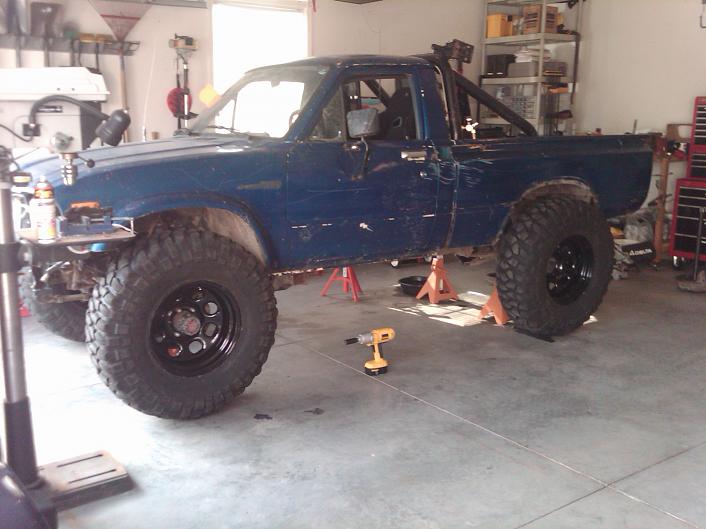

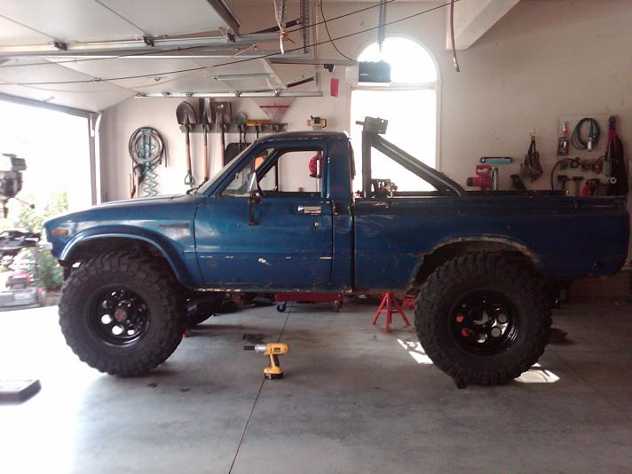

Sorry to disappoint. They are under a 1st Gen pickup. The axle is under a 2nd Gen 4Runner. I'm thinking of putting it under the back of the truck to get a little more width.
Pics of the truck just for fun ...
Attached Thumbnails Chromoly Axle Shafts for '91 4Runner-img00056-20090901-1711.jpg   Chromoly Axle Shafts for '91 4Runner-img00057-20090901-1711.jpg

It looks like your wheels are already almost stuffed, lol..

That was before any fender trimming and or axle movement. It's a rock truck with a low COG.

ohh
doesn't look like you'd get that much flex on stock-ride height.
how is it in the rocks?

I haven't had it out since it was on 33's.
Here's the plan ...
Front axle is moving ~2.5" forward and getting IFS hubs and a three link suspension with ORI struts.
Bed and frame behind the cab are going to disappear and be replaced by an IFS axle, tubed rear, four link suspension and ORI struts.
As it sits it has 5.29's and ARB's in both diffs, 4.7 gears in the case (I have an '81 that I'm stealing the case from for a doubler) and bone stock suspension.
I also have Trail Gear's full hydro steering setup sitting in the garage to put on when I move the front axle and do the three link.
This is my first Toyota so I'm learning a lot as I go. I've pretty much been a Jeep guy (gasp!) prior to this. Low center of gravity (COG) and minimal up-travel works very well in the rocks. If you're planning to run at high speeds, you'll want more up-travel but that can be adjusted pretty easily with air shocks or the ORI's.
