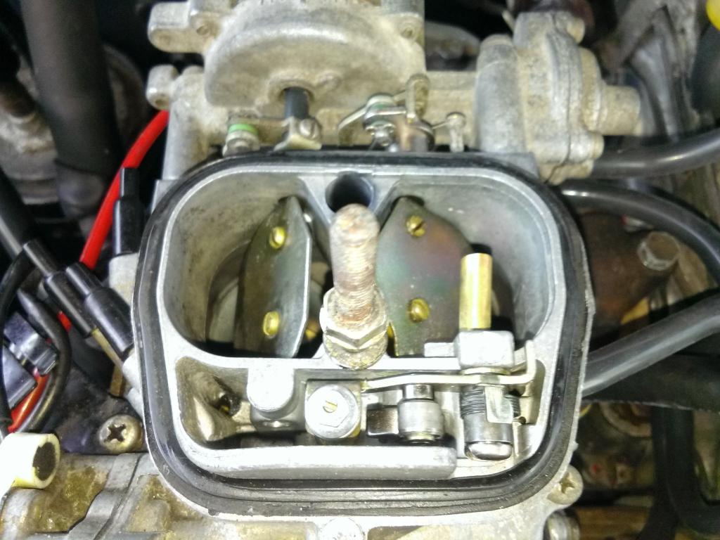

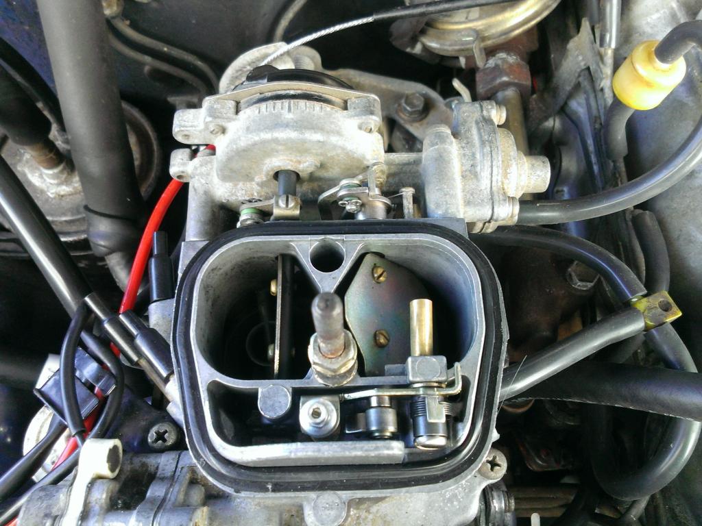

Rebuilt my carb, and having a weird issue where I cant get it to fire when cold because the choke isnt closing, but if I spray starting fluid in it to get it to start, the choke then closes once it's running, and stays closed until warm.
Any suggestions?
Choke when cold prior to first-fire:

Choke after starting w/ starter fluid

Main adjustment is by turning the black heater element.
Look at the pic you posted. The marks on the top of the choke body are to help in adjusting.
