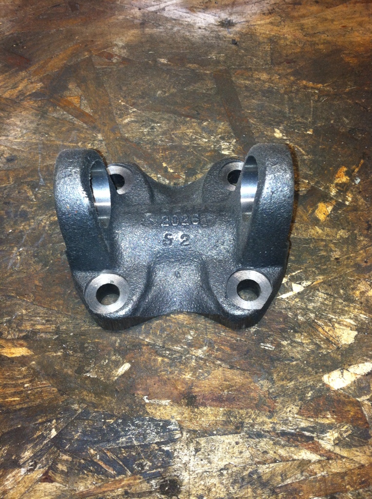

What tranny and t case are in your donor 73? I would just swap all the engine tranny t case if 350 th350 np205. Build new motor mounts or google search and buy some then build a t case crossmember. I ran chevy. Drivelines with toyota conversion joint at the axle but you could run toyota shafts with a conversion joint at the case. Or buy new flanges like this one takes a standard chevy joint (available at any parts store) and run the chevy shafts again.

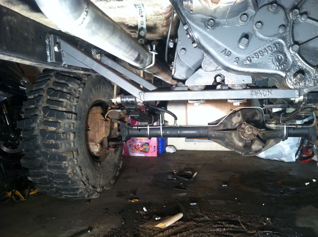

I'm running chevy t case. No issues with my frame and my 205 is clocked up some.
Okay thanks. I like how you made your cross-member as well, simple and clean.

From: matawa,wa
Thanks. It's not quite done yet. I'm gonna add some tube around the bolts on the bottom and build a skid plate into it. I'll also do a few more gussets. I think I have a few more pics on my build thread.
