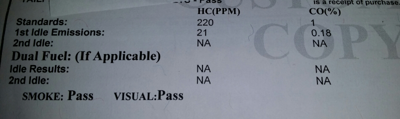

PASSED!
Much better numbers this time! I believe that after putting in the new o2 sensor and adjusting the timing, I didn't screw the distributor down hard enough.
Sunday afternoon when I was ready to give up, I checked the timing one more time and it was way way advanced. Set it back to 5 degrees and cranked that bolt down and boom, passed.
Thank you for all who helped or tried to help.

That's quite a difference, awesome! I'm running 3 degrees advanced and still passed. In California they (are supposed to) check the timing and you're allowed to go 3 degrees over specs. Wasn't your truck pinging it brains out with advanced timing and inoperative EGR?
