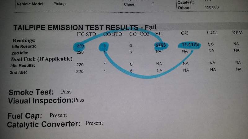

I have been trying to get past oregon emissions for a couple of weeks and just replaced my o2 sensor...
My hydrocarbons went up a lot from my last test and is 26x the legal limit.
My carbon monoxide went up a lot from my last test and is 6x the legal limit.
The lady at emissions place yelled at me to turn it off! Hahaha I guess my truck is pumping out the equivalent to agent orange.
The truck runs great, good power, timing is according to spec.
Any ideas on how my numbers could be so high?

Here's mine, it sat for 5+ years, put a fuel pump in it, changed fluids, drove it hard on the way to the smog shop to heat up the cat. The guy missed a few things on the visual inspection, but it passed the tailpipe test.
Old Feb 14, 2015 | 10:32 AM
bswarm's Avatar
Joined: Jan 2015
Posts: 592
Regarding your failed tailpipe test...
Did you gut the cat? if not it should be glowing red hot with that amount of HC. Your running rich too. Check your Coolant temp sensor, check for misfire, check the catalytic converter, lean the mixture at the AFM if unsealed. You can further reduce the HC by retarding the timing a couple degrees, but set it back after the smog check. Replace the plugs and do an oil change should help too.

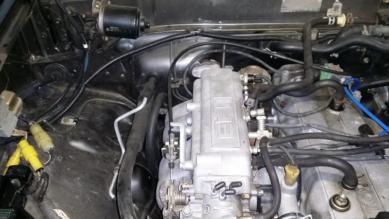

Let me know if this sounds like a misfire.
Old Feb 14, 2015 | 03:38 PM
bswarm's Avatar
Joined: Jan 2015
Posts: 592
Sounds ok, some valve tappet noise though. You might have to put the stock cam back in, replace the catalytic converter if it was gutted (I'll bet it was gutted for performance) It kind of puzzles me that it's worse with a new O2 sensor, might be a problem with it. That's a nice clean engine on the outside!

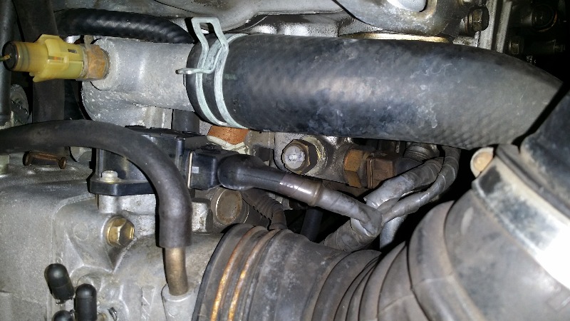

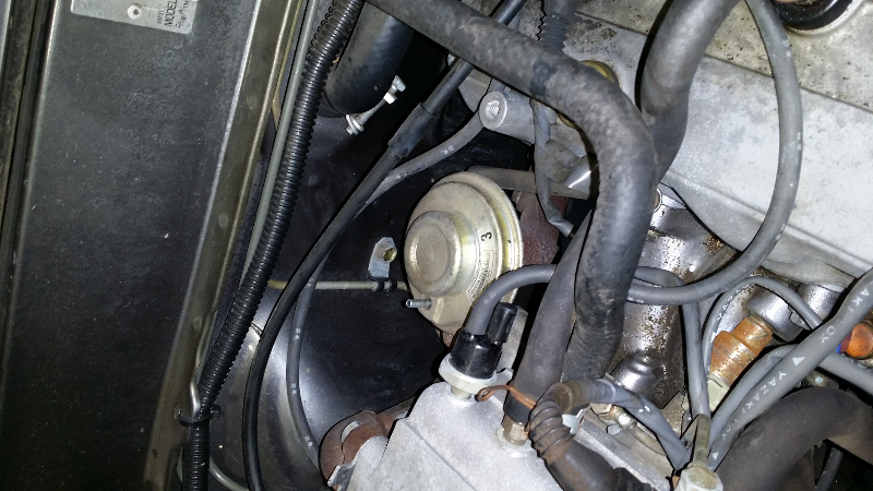

Here are some pictures of missing emissions equipment
Missing charcoal canister
Broken bvsv
Missing EGR vacuum modulator
Do you think these missing items could negatively effect my emissions in such a way that gives me the terrible result I have.
