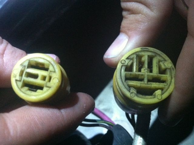

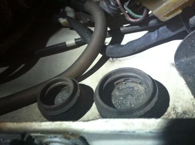

I found them, don't ask me how I did it.
I'm not familiar with this diagnostic port, anyone have some experience on this one?

Thanks. Well that's the one I think is it, I can't find anything else. So yes if anyone knows better please do tell!

Yep. On the left, smaller of the two. Do you get a CEL before cranking, with key on? Turn key on, see light steady, insert jumper, count blinks of CEL. Should get ya started.
