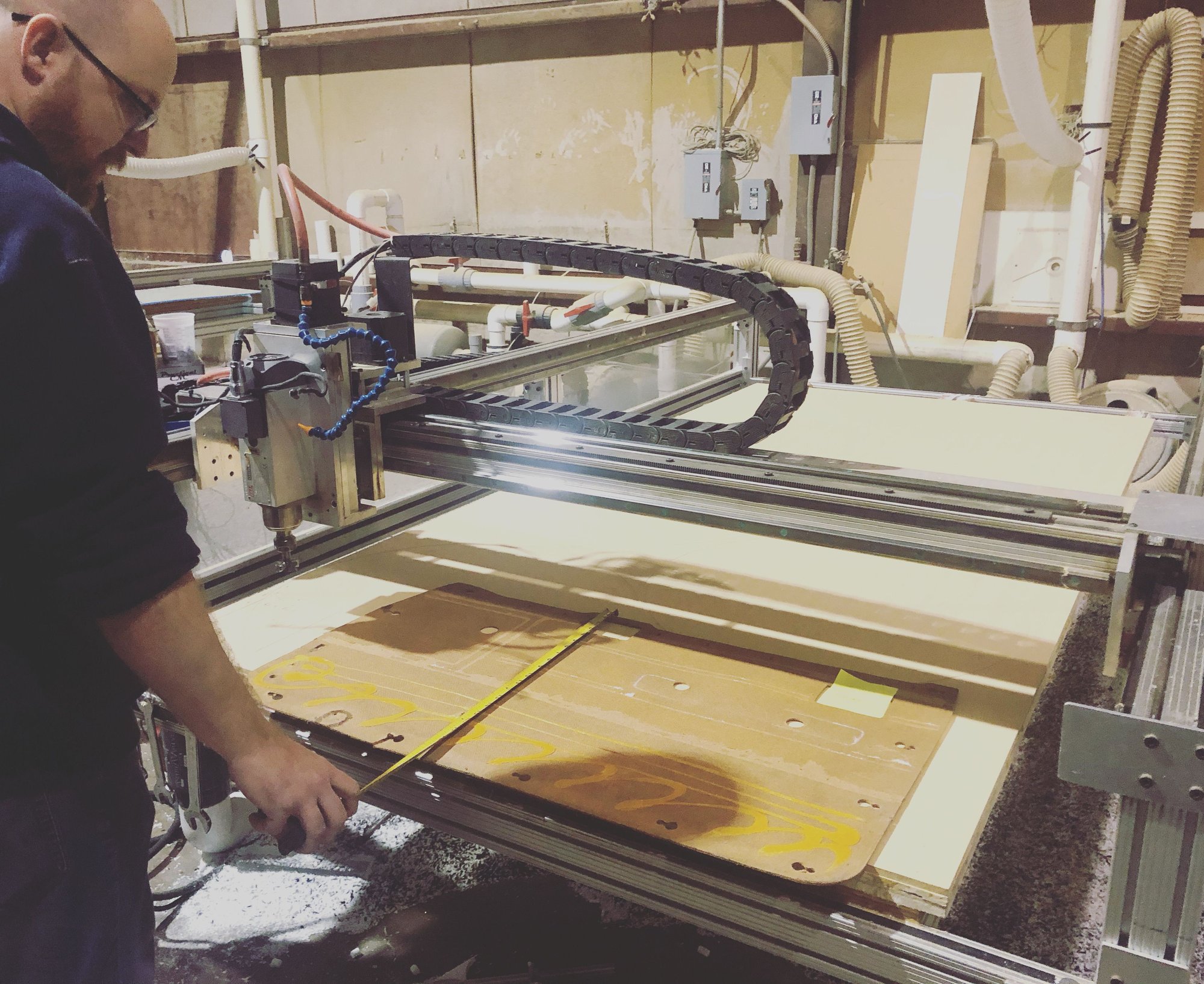

so i went out on a limb and decided to dismantle one of my door panels. i am having the same CNC shop that did my tail gate panel make me some door panels. i am using 1/8" ABS for the doors, i used 3/16" for the tail gate. i will post some pictures when they come off the machine tomorrow. FYI, i have sold several tailgate panels. i am selling for 85 bucks plus shipping. this gets your a panel thats CNC cut and drilled, new hardware, and im applying some thing weather stripping to the back for a nice snug fit. you can PM me here if your interested. i have 3 left from my current batch that are not claimed yet. black is the only color i can get right now but im checking into grey.

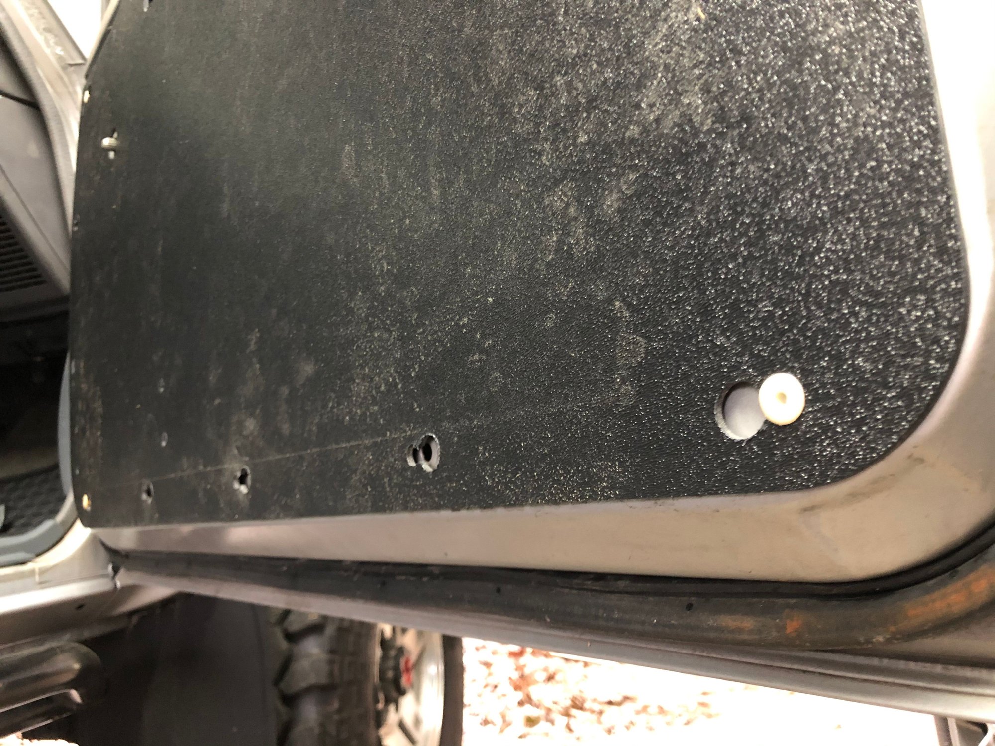

Door panels are up. What do y’all think? They fit well I think.

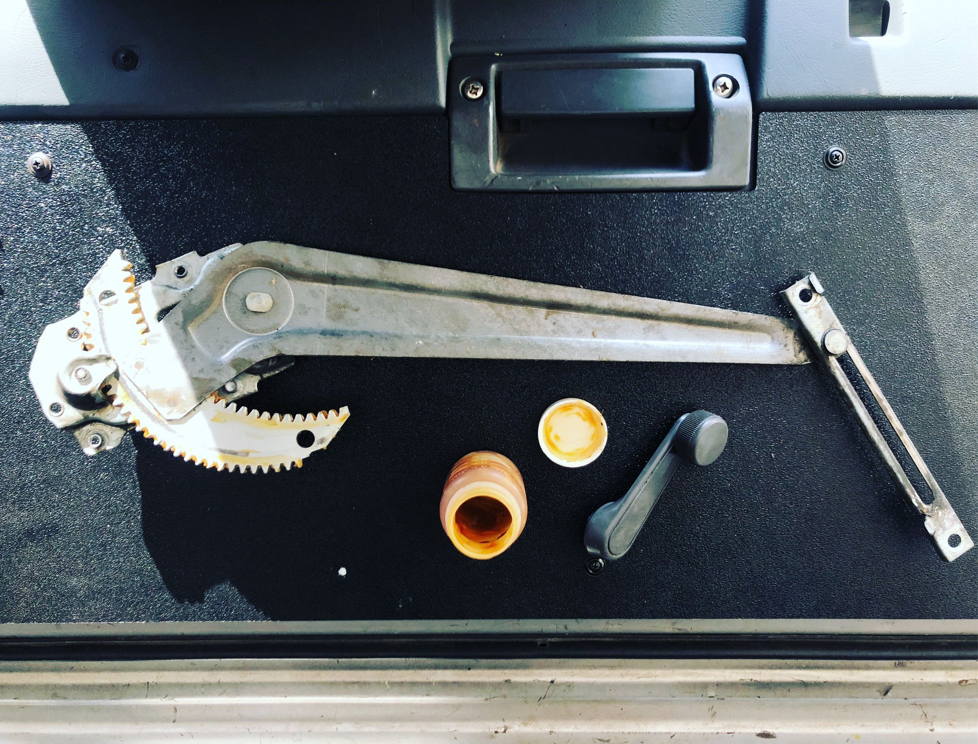

Today I got good progress on the door work. I installed new window channels runs which is a breeze. Best to just slip the ends down then pop the upper portion in place. I hand washed the oem skins and fit them to my new ABS panels. I recovered the upper portion of the door panel with some leftover headliner vinyl from when I did my headliner. I put in new lock bezels, easiest to just run a solder iron into the little pegs on the bottom to melt them into place. Also I’m swapping my nylon nuts over to another style from Toyota I really like. Will be putting the moisture barrier in tomorrow and once the rest of my nylon nuts show up I can fit the door panel on for good. I also have new handle bezels on the way.

I removed the regulator and dropped the window all the way down. Which reminds me, I also cleaned the old sticky grease from my regulators and applied some new roller bearing grease, I forgot I mention that above. I did not use weatherstrip adhesive the new channels popped in nice and snug and do not move.
The regulator has 3 10mm bolts holding it onto the door and 2 10mm bolts attaching it to the window at the slide.

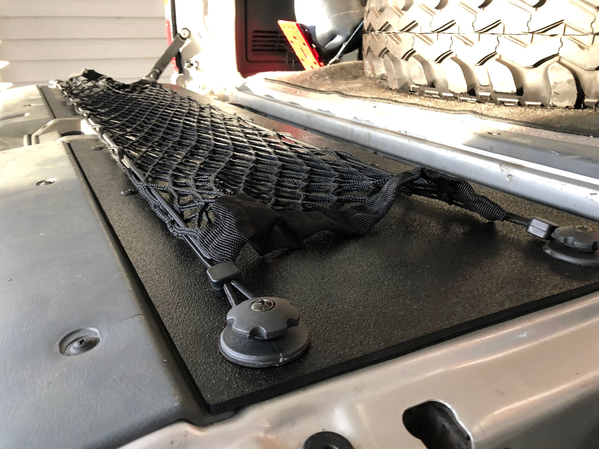

Moisture barrier and final install today
Today I had a parts expert I know at Toyota check the window sweeps I had come up with. They were for the pickup, which uses a different armrest design than the 4Runner. 4runners inner sweeps were discontinued 10 years ago. You might could get really crafty and bend open the metal brackets on 4Runner sweeps and cut up the pickups ones to install them but mine weren’t in that bad of shape so I reused them. The moisture barrier was a pain because it’s messy. I did my best not to spread the weatherstrip glue everywhere. I ordered new OEM window crank handles, the nylon disks, and clips, and door handle bezels which havnt come in yet, but here’s the panel installed. i also picked up this generic cargo net from amazon with some
mounting hardware. I simply replaced the #8 screws in the corners with the mounting hardware for the net. Looks good and will be handy on my new tailgate panel.

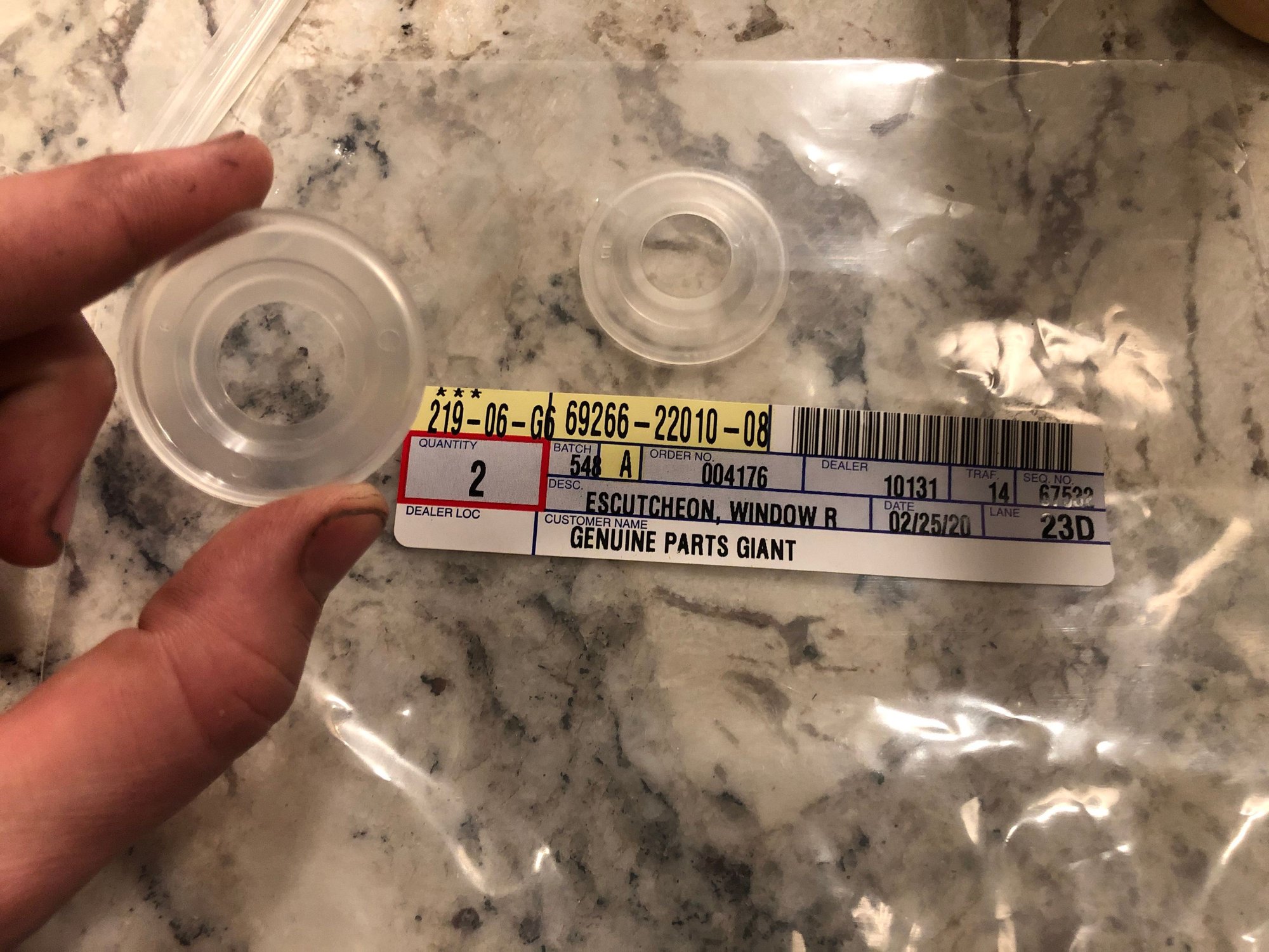

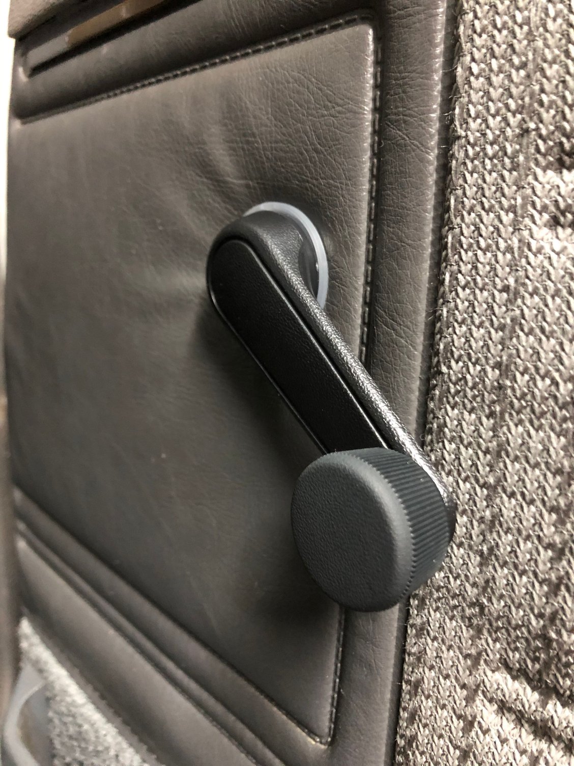

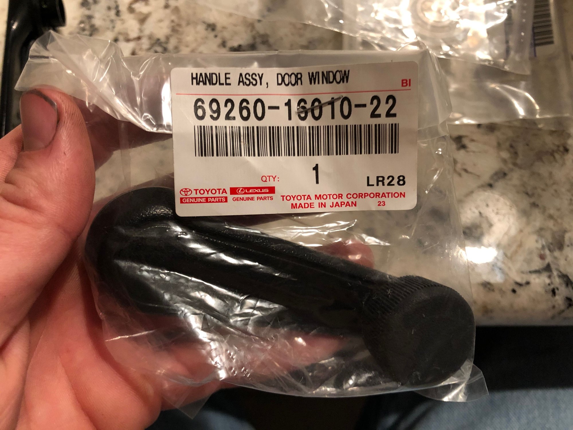

door refurb continues. I ordered new crank handles and the plastic spacers for the windows, although my handles came in black instead of gray like I ordered, not even the same P/N so ive got to call about that.
Old Feb 29, 2020 | 09:42 AM
  #179
old87yota's Avatar
Joined: Jun 2013
Posts: 3,112
Likes: 582
From: Portland, Oregon, USA
Originally Posted by keycw
door refurb continues. I ordered new crank handles and the plastic spacers for the windows, although my handles came in black instead of gray like I ordered, not even the same P/N so I've got to call about that.
I once ordered Genuine Toyota Wiper blades and when they arrived, they were a slightly different length and a different part number I ordered. What they probably did was substitute an available part that is functionally the same as the part number that you ordered. This might mean that the part number you ordered isn't available.
Old Feb 29, 2020 | 09:57 AM
  #180
keycw's Avatar
5 Year Member
Joined: Dec 2017
Posts: 780
Likes: 466
From: fort smith, arkansas
this is exactly what I suspected so I emailed them this very question. im totally ok with the black handles BUT if grey is still available ill take them. I still have my old faded/sunstained ones if I really needed grey.
