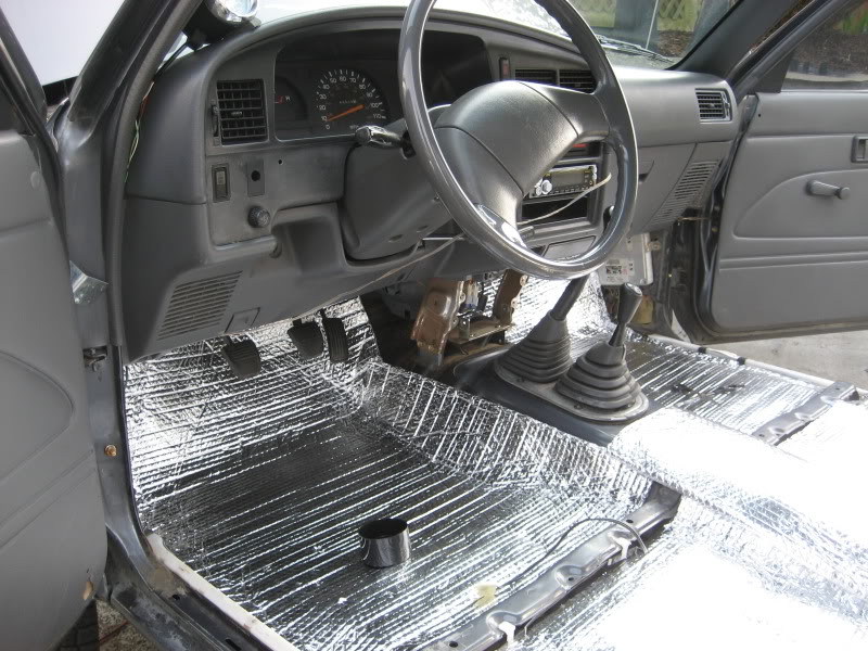

After ~20 years of existence, the plastic "covers" around the steering stem at the firewall, and the two pieces where the hood louvers connect inside the firewall were/are worn. So worn, in fact, that you could see daylight through them, depending on your vantage point.
Stopped at ACE Hardware yesterday, bought some of that expanding foam insulation made for insulating around plumbing, etc. Per instructions, I VERY CAREFULLY added some to the gaps indicated and let it dry for about half an hour (steering stem from engine bay and under the dash). Worked great! Really cut down on the noise when behind the wheel, especially with the clatterbox that is the 22RE. Only about $3-$4 for the can. Stuff is sandable, paintable, and cutable when cured.

EDIT: Forgot to say that it's probably 2-3x quieter in my cab. I also put a double layer of the insulation next to the firewall and around the transmission.

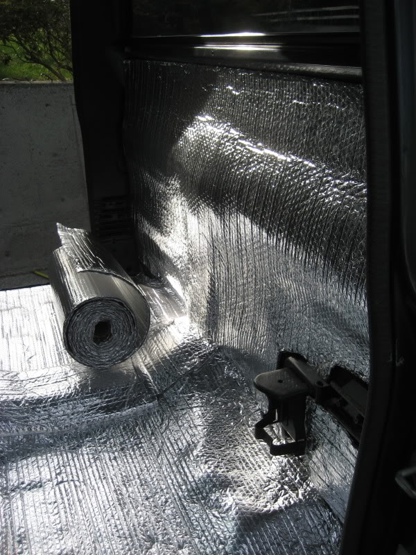

here are some photos from when I did mine:
this is what the rear of the cab looked like on one side. I pulled the trim panels and stuck this stuff right to the body. if you notice, I even put it inside that little speaker cubby.

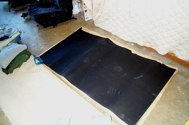

this is a photo of a sheet of the mastic itself. 32" x 54" sheets, I think, self adhesive. cuts very easily with the utility knife, as well; soft. the only thing about this stuff is that it smells for a few days after you install it, but it goes away entirely not long thereafter. I'd definitely do this all over again. our trucks are so light and tinny sounding without. with this in the doors, they feel and sound a lot more solid.
my question would be one of sound deadening versus insulation. the mastic deadens vibration, and you don't need to cover the entire exposed metal surface for a reduction in sound. however, for as cleanly as the Reflectix went down, as shown in Monochrome's photos, I'd be hard pressed to make a decision on which material to use. I guess it would depend on your goal. I would imagine the Reflectix does a much better job of insulating against heat, while still providing good sound deadening. I definitely think the Reflectix would be better for the cab floor and firewall, but I would still probably want to keep the mastic on the verticals and in the doors. I'd love to go for a ride in Mono's truck though to compare. I really like how clean the Reflectix looks and how well it conforms to the contours. it almost looks like a pro kit he bought and installed.
that's one of my bucket seats in the background for scaling.

well, the acoustic mastic is not actually foam; it's more of a rubber material. it's maybe 1/8" thick, or so?
that second photo I posted is a bit misleading; that white foam you guys are seeing is the padding on the bottom of the carpet, which is folded back in half.
