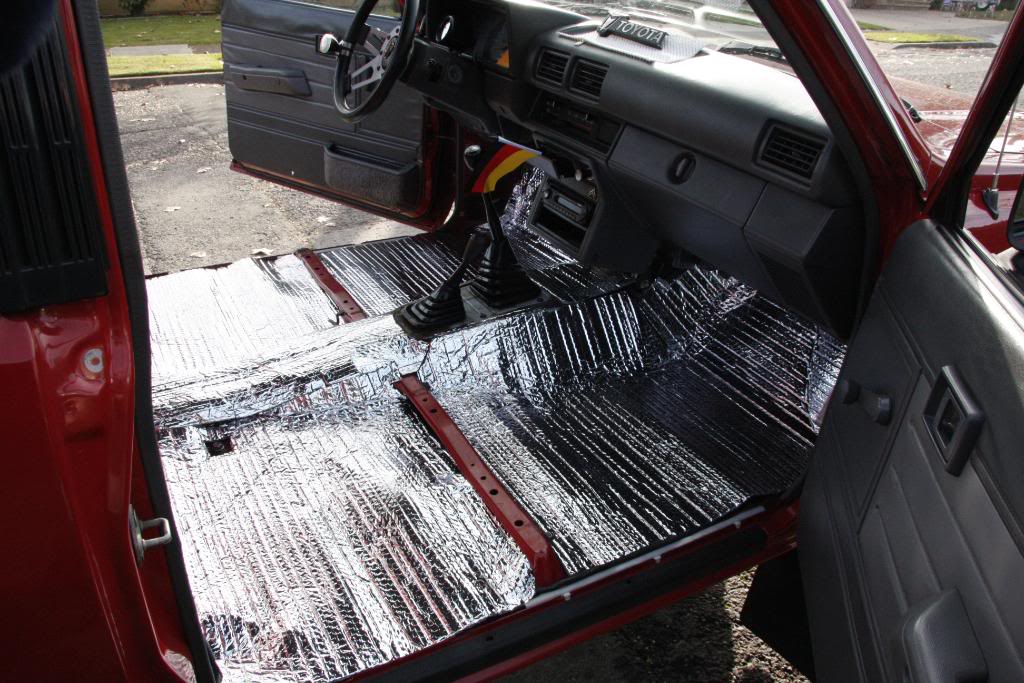

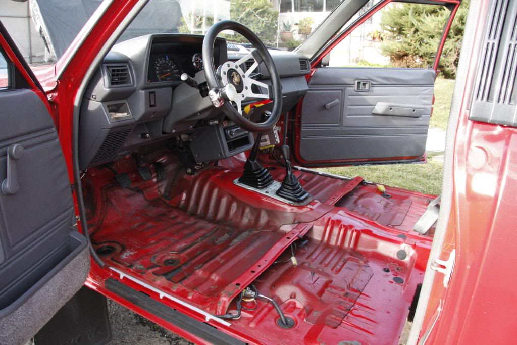

ok, so a bit of an update from my installation:
i've had it in for almost a year, and i can safely say that i think there are better ways to insulate the cab. the noise reduction is mediocre, and it kinda keeps the air conditioning in. that being said, it works extremely well keeping the heat in. if it's sunny out, i barely use the heat, and if it's night, all i need is the heater on low/med low. love it in the winter, it's okay in the summer.
my $0.02
