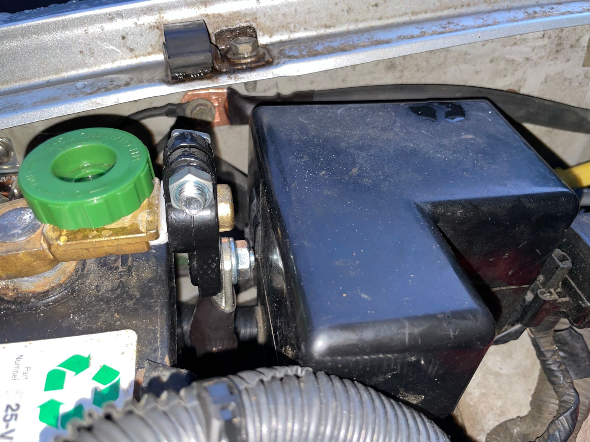

Hey folks! I acquired an ‘87 4Runner a few months ago, and I’ve been googling how to repair some of the issues it has. Here recently, it wouldn’t crank. The battery was at or juuuuust below 12VDC, and nothing would happen when I turned the key. I jumped it, and I was reading 12.5 at the battery and 13.8 at the post on the alternator. The alternator harness (from the alternator to the plug at the passenger fender) ohm’d out fine. No opens or shorts. I decided that while the alt wasn’t at prime operating condition, it “should” be giving me enough to charge the battery - so I ran the “big 3”. Overkilled it, really: 0/1 from the alternator to +batt, with a 150amp fuse in hopes of an alternator upgrade in the future. 0/1 from -batt to a bus bar, with the same gauge wire going from -batt to the block, frame and passenger fender. Added 0/1 from the driver’s side of the block to the frame and 6awg from the head to the firewall. Cranked her up and I was reading 13.8VDC at the battery, and at the alternator post. She drove like a champ for about 10 miles and started to die out on me. First indication of it was the rear window going up slowww after my kid grabbed his football gear out of the cargo space. I killed the A/C & headlights and got back to the house. Pulled out the meter and read just above 12VDC at the battery and alternator. Turned her off and tried to crank her up again. The starter got it to turn over about twice and then nothing.
As far as the new wiring I installed, I’d read up a lot about this modification. I watched many YouTube videos, and all of them advised to reinstall the factory charge wire onto the alternator as well as the new fat wire, as well as hooking the fusible link to +batt,
0/1 & stock charge wire
-batt connection. All sheet metal connections were made to bare metal
+batt to fusible link, alt charge & starter
150amp fuse between the alternator & +batt (about a foot away from the battery)
6awg from the head to the firewall (bare metal)

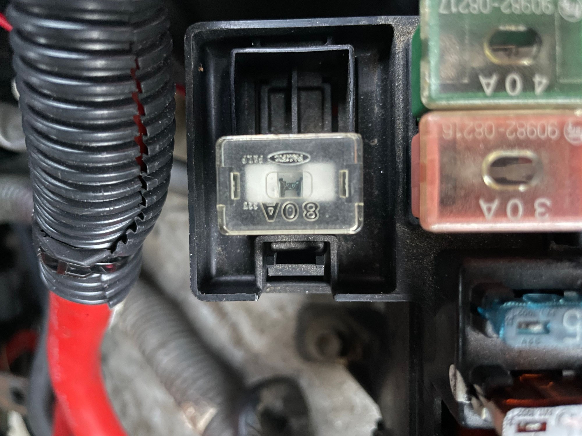

I pulled the fuse box cover and noticed that the 80amp fuse element is now black. I distinctly remember that it wasn’t in this shape earlier this morning, before I ran this mod.
With this being the stock alternator, I can’t imagine this mod would be the reason that fuse is blown - but I’ve been wrong more than right.

Thanks, Pat! I do think that the fusible link is still good, or was at the start of all this. I had thought of pulling the fuse box to ohm it out before buttoning everything up, but at this point there’s no reason not to since I’ll already have it apart to swap out the 80amp fuse.
I’ve been looking at the pics I uploaded, and thinking…. It looks an awful lot like my new 0/1 terminal lug at the alternator is possibly touching the case. That could be my short. I’ll verify in about an hour and a half when I get home from work.
in your opinion, would it matter if I just unhooked the stock power wire from the alternator? Of course, I’d like to remove the whole run going to the fuse box. I ask because I’m wondering if the fuse box will still be operable with the power to it is coming from the battery through the fusible link, as opposed to the power to it is coming from the alternator.

Well, the system is designed to have the alternator feed the fuse block. The alternator feeds the far side of the 150A from the battery, and the FL from the battery feeds the "near" side, IIRC. That's where the fusible from the alternator goes, I believe. I've been wrong before. Often. Check your local FSM Schematic to be certain. YMMV, and so forth.
Anywho, The alternator feeds into the fuse block through it's fusible link. That's how the system is designed. If you want to replace that FL with a heavy cable, it's on you. You might go years, and thousands of miles with no trouble at all, but if, IF I say, there comes a time that the FL from the alternator will save the fuse block from a fire, you'll regret replacing the FL with a heavy wire. It's similar to replacing a fuse with a chunk of wire.
As long as the fuse block is getting a feed from the alternator, the big post on it's side, the system will be happy. If you remove all feeds to the fuse block from the alternator, what's going to charge the battery? Yes, the system will run on the battery alone, but not for long. Again, check the schematics. The fuse block needs a viable alternator feed to function correctly. It spreads from the fuse block to the rest of the system. That is what keeps the battery charged up, as well as running all the trucks systems. Yes, you could replace the FL with a big wire, as long as it goes where the FL went into the fuse block.

Got to the house and started probing around. The battery has dropped 3VDC in 24 hours, and I believe it’s because I fried my alternator.
I removed the 80amp fuse, and it read zero ohms. Same for the fusible link. Since it’s already apart and AutoZone has them in stock, I’m going to go ahead and swap out the fuse. As far as the fusible link, I cannot find them anywhere.
None of the other fuses in the fuse box are even slightly damaged. Clear as a bell & totally in tact. The fuse box did have a burnt smell to it, but I couldn’t find any damage. Nothing charred or melted underneath.

I need to get one of those FSM’s you speak of!
Also, am I reading your post right in that there are fusible links on both ends of the fuse box? One in from the alternator and one in from the battery?
My thoughts were to run the alternator cable to the battery, at the positive post, also therefore to the fuse box through the fusible link attached to the same post.

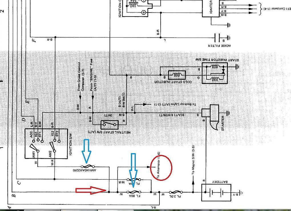

OK, here's a section of the schematic in the FSM. It's the section involving what we're talking about. FL 2.0L is the fusible in from the battery to the fuse block. The red arrow is where the wire from the alternator comes in. No, they don't show the FL off the alt in this schematic, but it's there. One blue arrow points to the 80A Fuse which they call a fusible link, for whatever reason. The other points to the 140A (in this schematic it's 140A, in your truck it's 150A). The electrics in Toyota trucks change year to year, sometimes month to month, but overall, this schematic is accurate. You can see where the wire from the alternator meets the fuse block. Right between the 80A and 150A fuses. The wire that specifies that it goes TO the alternator is th always hot that provides the field coils with the voltage that makes the alternator work.
The 140A and 80A fuses connections are on the bottom. You have to take the part of the fuse block out and turn it upside down, essentially, to get to the connections. Be careful, some of the connections are a little close together, so a large terminal could connect something you don't want connected.
Does this help, at all?

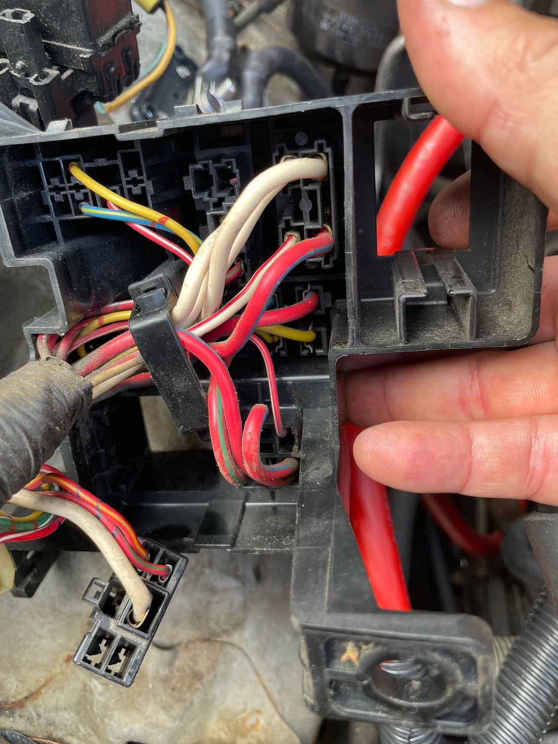

Ok I’m picking up what you’re putting down. However, my fuse box doesn’t have and fuse over 80A. The other two that remain in the box are 30 & 40A. Also with that said, I cannot tell which wire the runs to the fuse box that could be a fusible link. I trust what you’re telling me and the schematic clearly shows two fusible links, one going to the box and one coming out - but I can’t discern which one is the FL. The parts store has an 80A fuse on hand, so I’m going to have my alt tested and put everything back together. If I can get her cranked up, I’m going to check voltage at each fuse, as well as what I’m getting out of my alternator.
Top of the fuse box. No 150 or 140A fuse. I’m guessing that if it were, it would’ve men installed below the 80A?
Wiring going to the fuse box from the harness. Other than the wiring going to the 80A fuse, and the two plugs going to the top of the box, These are all the wires I have. I can’t see where anything was clipped or pig tailed back into the harness in any kind of “delete”.

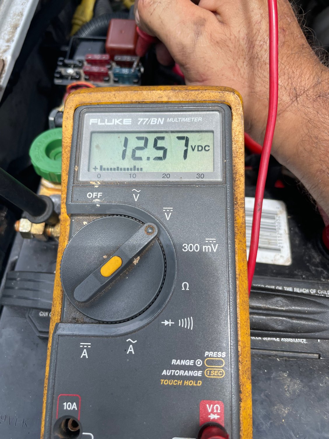

With the alternator out, I’ve taken some voltage reading with the key switched “on”, and with 12.61VDC, I had 12.49 @ B, 12.55 @ S, 12.34 @ IG & 11.83 @ L.
11.92 @ both sides of the 75amp fuse
.004 @ both sides of the 10amp fuses
12.57 @ both sides of the 15amp fuse
All these were with the switch on, and not running. I’m having a local shop rebuild the alt and they’re hopping it up to 180 amps all for less than a parts store reman. They also did say that it was really fried. I’m just trying to figure out if the alternator was the problem all along.
Battery voltage
75 amp fuse
Top left 10amp fuse
15amp fuse
Bottom left 10amp fuse

I'm not one to quibble, but that first fuse you checked was a 7.5 A fuse, not a 75 A fuse. Seven point five amps, not seventy five amps.
Because those two fuses on the left have zero volts on them, BTW: did you check BOTH sides of the fuses? and did you check the fuses for continuity? anywho, because there's no voltage on them, check the schematic. Where do they normally get their voltage from? Back-track until the line(s) feeding those two fuses shows good voltage on them. They could be the headlamp, OR the high beam fuses. If so, without the right switchology, there won't be any voltage applied to them.

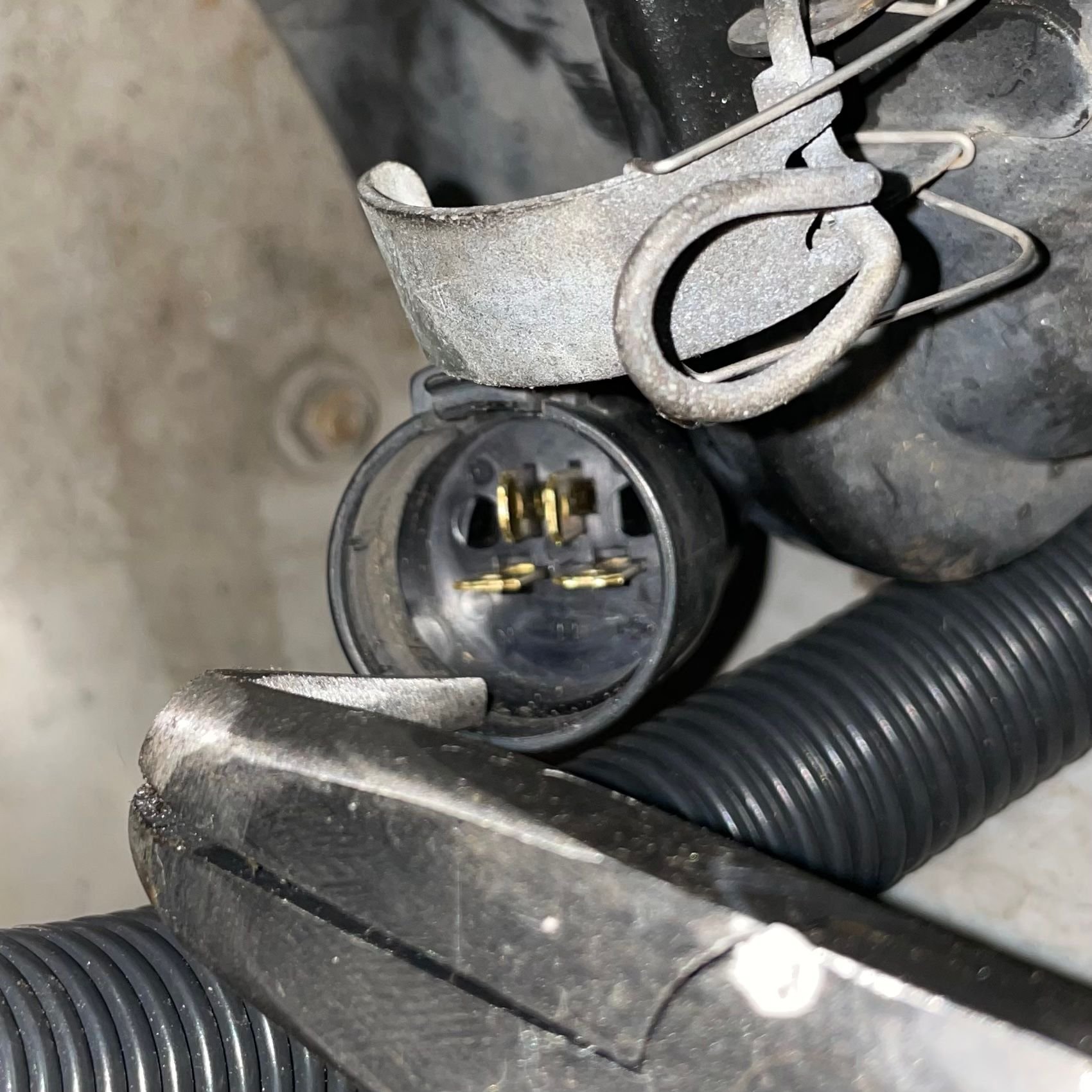

In light of these readings, I decided to get a closer look at the loom coming from the driver’s fender to the fuse box. All of the wiring looked like it was in good shape.
I pulled the 30 & 40-amp fuses and narrowed the ground to the left pin (as seen while looking at the fuse box from the front of the vehicle) of the 40-amp fuse. This wire splits into two and is connected to a cannon plug at the driver’s side between the fender & air box, directly behind the headlamp. The other shorts were eliminated with the 30 & 40-amp fuses pulled.
I checked for ground at both terminals for these wires, and I read 7.0 ohms at the top right terminal, as seen while looking directly at the male plug terminals.
By then it was getting dark and I had to pack up for the evening.
Does anyone know where this particular section of wire goes to? It appears to be going to the marker & turn signal.
Left terminal for the 40-amp fuse is shorted to ground.
Top right terminal yielded 7Ω to ground…. Appears to be a short?
