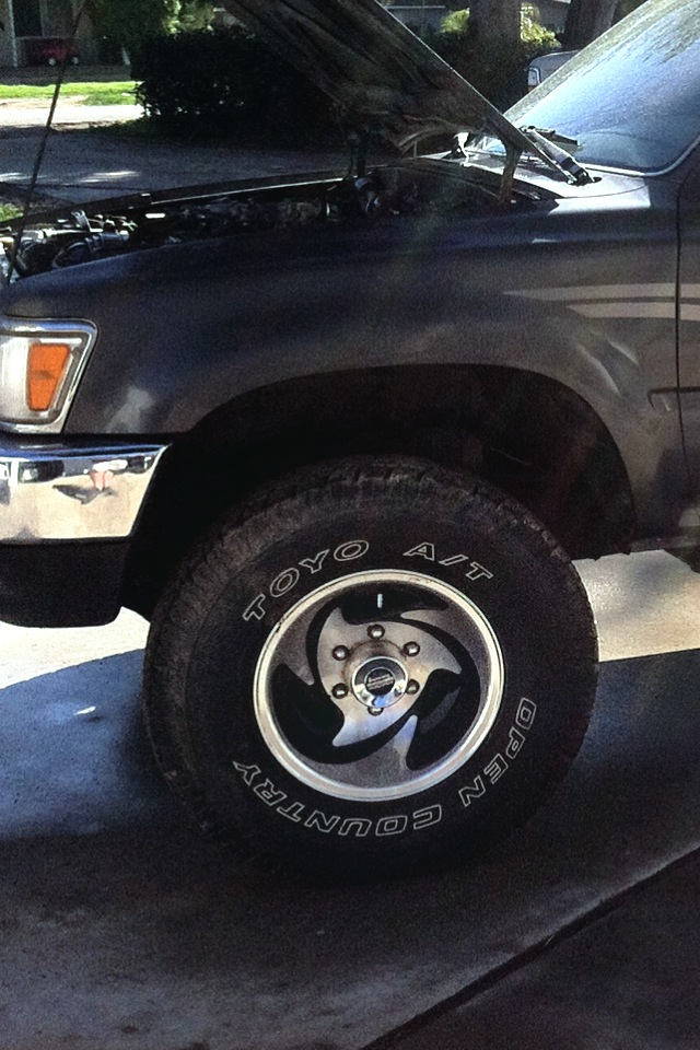

Anything helps Jason! And i'm actually in the process of figuring out exactly what combo I want to do for that. I've been thinking on it for a week or so. Im gonna attempt to upload a pic of the wheels/tires i have now

I know it's small (Never had that problem before LOL!) but thats the best i could do for now. The wheels seem light from when I've had them off the truck but can't find what wheels they are. Got 'em with the truck

The center cap looks like American racing. If they are wide that will hurt your mileage. They look to be aluminum so that should help. Have you already tried the basics like air filter, oil change, other fluids tire pressure and removing excess weight on the truck. Have you corrected your distance traveled because of the larger than stock tires when you calculate your mileage?

The calibration and everything on 'em is correct with the bigger tires. Previous owner took care of that for me. And they are American Racing wheels and im PRETTY sure Aluminum. What I'm thinking about doing is keeping these wheels with a set of road tires on them and throwing some All-Terrains on a set of Pro-Comps for 'froadin'.
