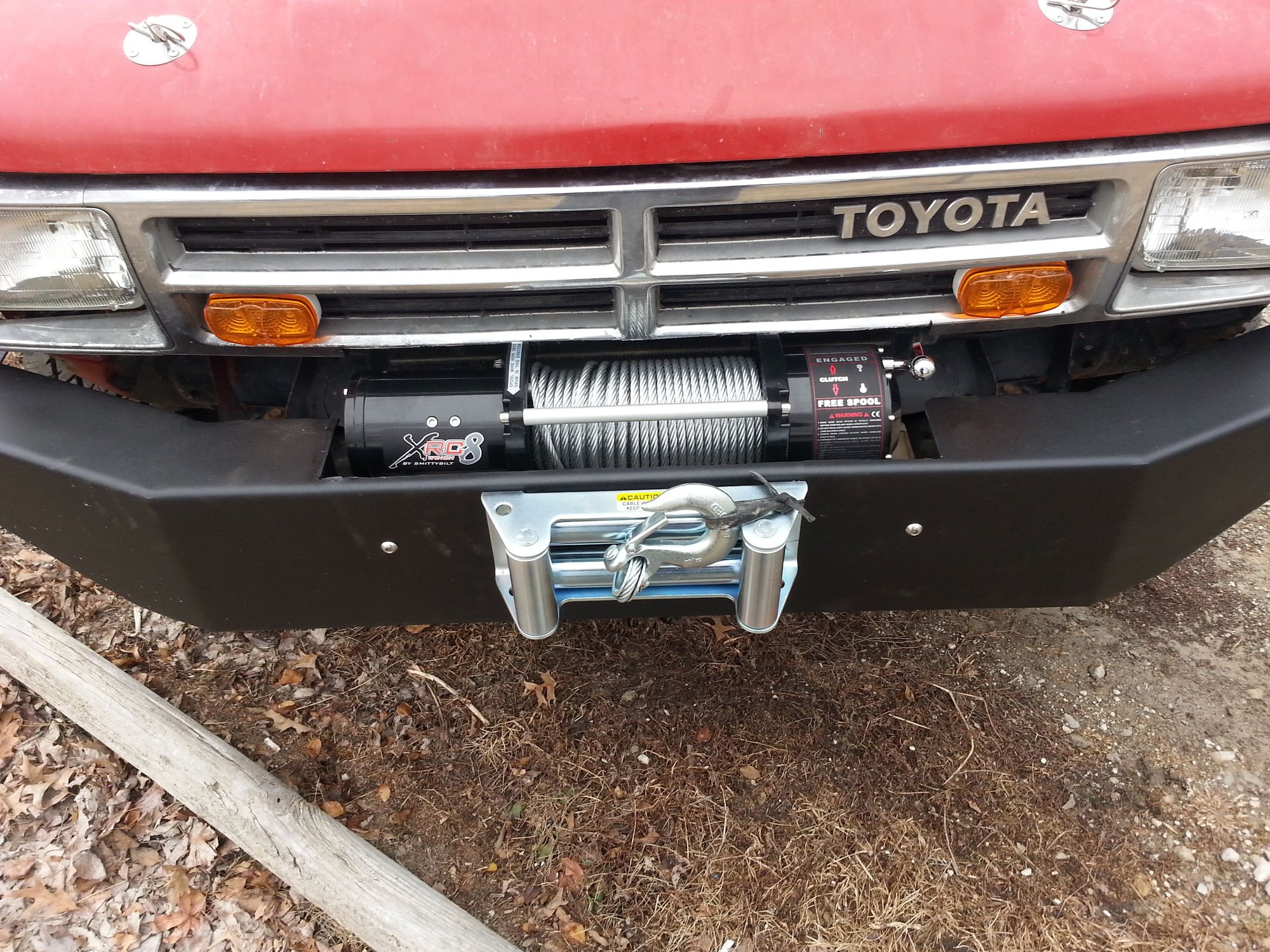

Here is a pic from my phone I made a custom front bumper and winch plate out of 304 stainless here is before paint and winch looks bulky
Not to bad for first time new smittybuilt xrc8 winch

Nice looking truck and you did an excellent job on the bumper. Welcome to Yotatech.

Thanks very much I wish I would have made it about 2 inches shorter o well beats paying big bucks for one lol thanks again

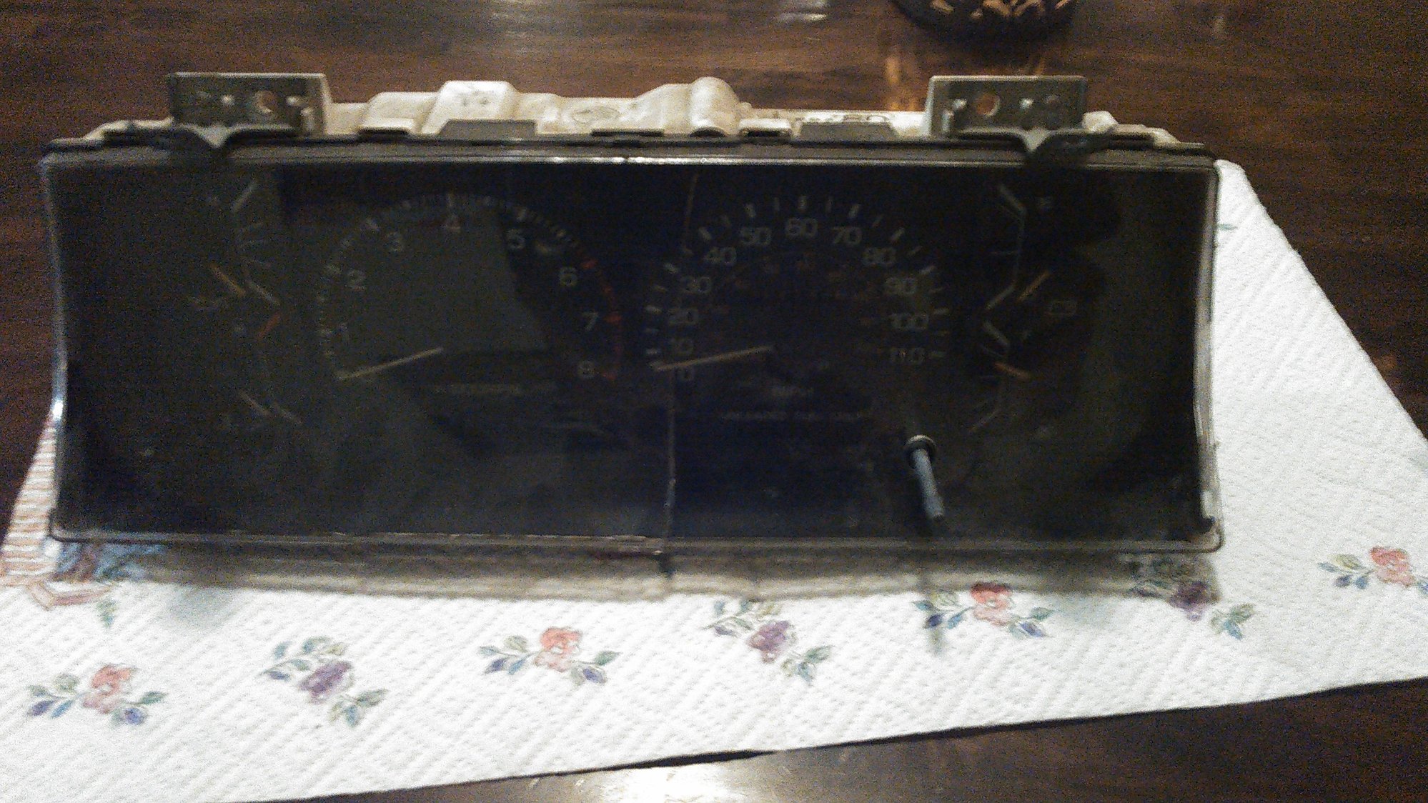

We'll rear is getting close need to put new whell bearings in so done for the day tried to set the tach in sr5 gauges it was in a 3.0 tried to remove cover and cracked it I think I should call it a day

If the gauge set you are replacing doesn't have a crack you can use it. Just hold it over the new one and drill a hole for the odometer knob. Terry87 did it on one of his builds so there's pictures somewhere on here.

You can use a non SR5 gauge face plate. Just need to drill the hole. https://www.yotatech.com/forums/f199...l#post51712377
I cant see which guage you have but if it is the hash mark gauage, I would not pull the speedometer needle off to set the correct mileage. They tend to break. I posted on the SR5 gauge thread on another way to correct the mileage on it. It is a Youtube video I found.
