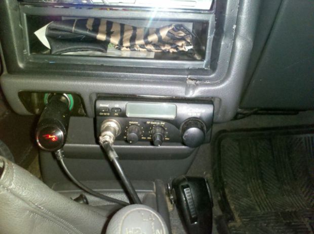

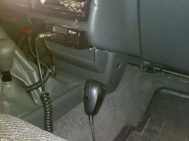

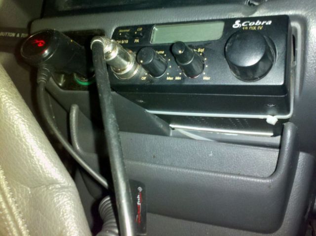

I removed my useless ash tray and the mount for it. removed the whole section of console so that i could tap into the cig lighter for power. then i took a dremell to the plastic behind it, cut it all out. to mount the cobra i used double sided foam tape and industrial zip ties to secure the unit. i will post a pic tomorrow once its light out.

I am able to get into 5th fine with my mic plugged in. CB radio install suggestions/pics-cb-3.jpg
CB radio install suggestions/pics-cb-2.jpg
CB radio install suggestions/pics-cb-1.jpg
